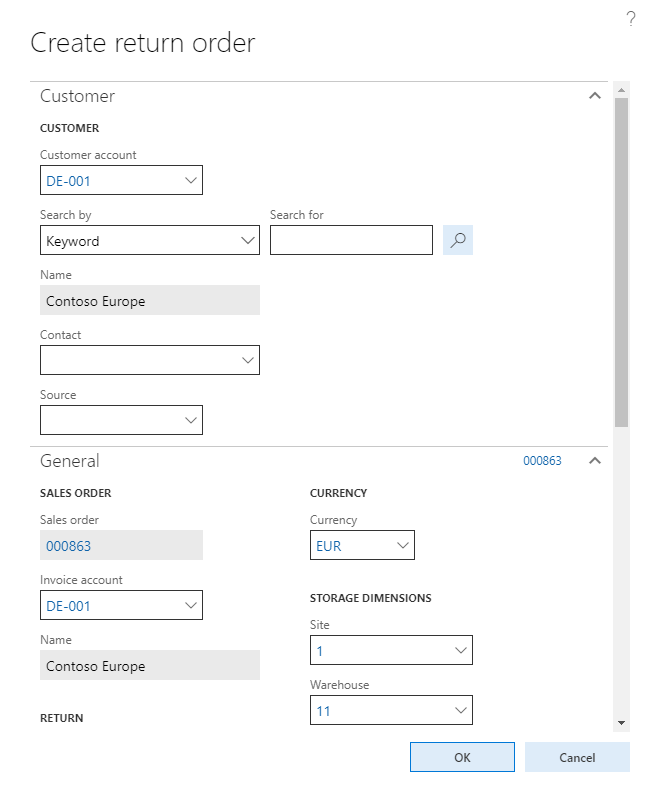

1. Go to Sales and marketing --> Sales return --> All Return orders
2. Click on New
3. Select customer account for which we are initializing the return
4. Click ok.

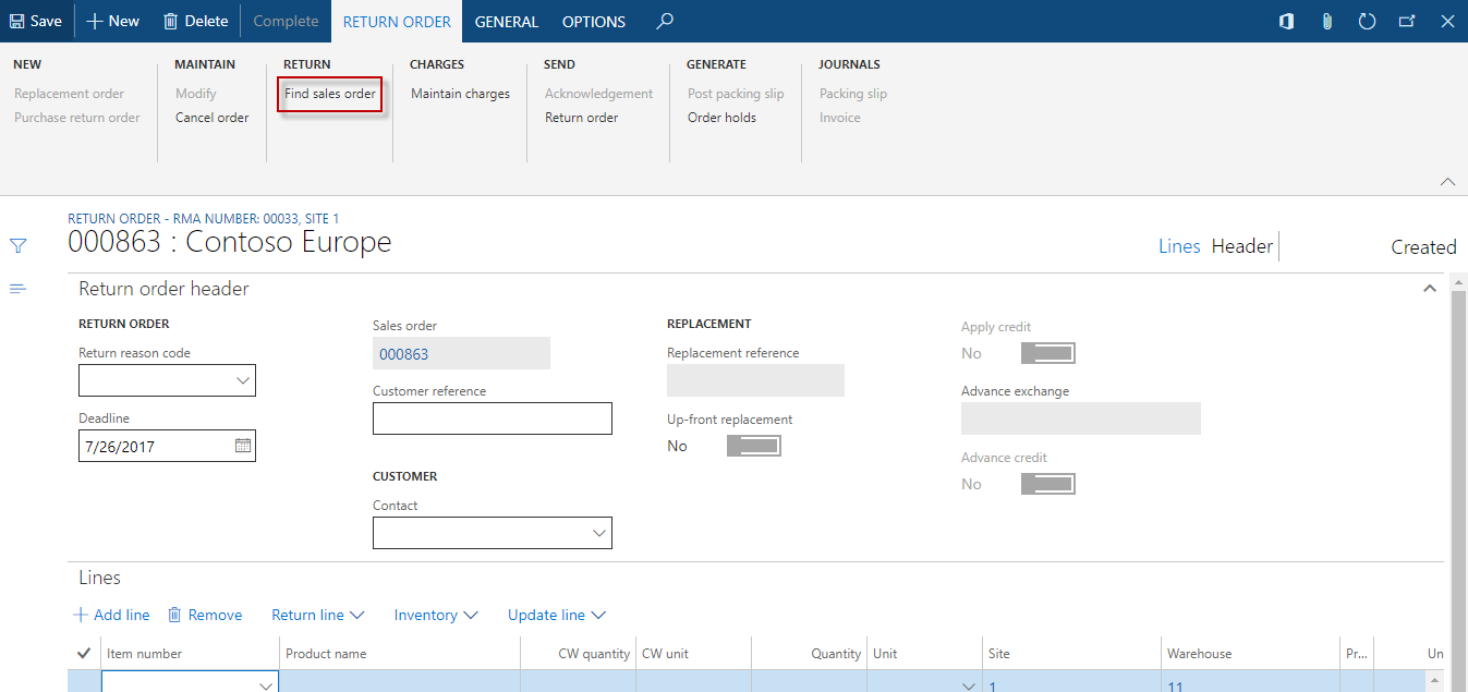

5. Click on Find Sales order.
6. Select sales order, specific sales order line/s and quantity to return
7. Click ok to get the line/s in the return order.
