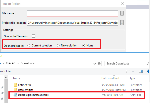

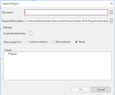

Import Project
Following steps are required for importing project in D365.
1. Open visual studio as administrator.
2. Go to Dynamics 365 -> Import Project . Or you may open the import screen by pressing Ctrl+R and Ctrl + P keys.
3. Now select the file from your required path.
Note : Project file will be in axpp extension.
You will be having three options to open project.
- Current solution : Open project in current solution
- New solution : Open project in new solution
- None : It will just overwrite artifacts and solution won't be saved.
4. After selecting file from path. The hierarchy of artifacts will be shown in this way. You may select limited or all artifacts for overriding.
