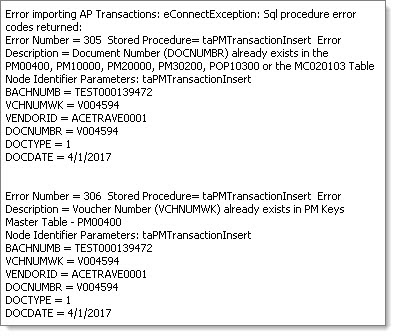

At GPUG Summit 2015, I gave a presentation "5 Tips for Developing GP Integrations". After the presentation, two attendees indicated that they were receiving these types of errors when import AP vouchers using eConnect:
Error Number = 305 Stored Procedure= taPMTransactionInsert Error Description = Document Number (DOCNUMBR) already exists in the PM00400, PM10000, PM20000, PM30200, POP10300 or the MC020103 Table
Error Number = 306 Stored Procedure= taPMTransactionInsert Error Description = Voucher Number (VCHNUMWK) already exists in PM Keys Master Table - PM00400

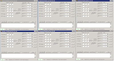

However, since I had two people in my GPUG Summit session tell me they were getting this issue, out of curiosity, I just setup 3 instances of an AP voucher import and had each of them import 1,000 vouchers at the same time. They were running fine for a while, but then it happened.
Sure enough, having 3 simultaneous eConnect voucher imports produced the error pretty quickly. So I opened up the procedure to see if I could tell how this could occur.

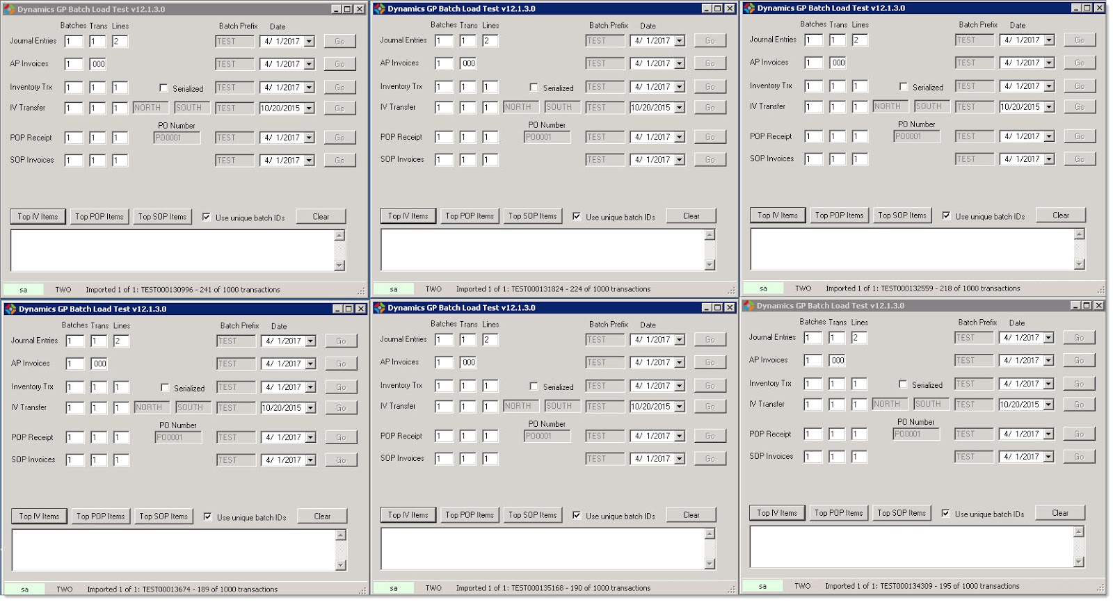

With the modified taGetPMNextVoucherNumber procedure in place, I launched 6 instances of my eConnect Batch Load Test tool and imported a total of 30,000 AP vouchers over 5 different runs. The error didn't occur.
