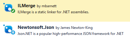

1.        Add ILMerge Nuget to your plugins project
2.       Add Newtonsoft.Json Nuget package to your plugins project
3.       Now you simply need to edit your project configuration in Visual Studio such that when you build your plugin it automatically merges it with your reference assemblies (so you will never have to manually do ilmerge). To do this go to the “Build Events” tab of your project settings and under “Post Build event command line” box enter the following:
$(SolutionDir)packages\ilmerge.2.14.1208\tools\ILMerge.exe /keyfile:$(SolutionDir)/.snk /target:"library" /copyattrs /out:$(TargetDir)$(TargetName)$(TargetExt) $(ProjectDir)$(IntermediateOutputPath)$(TargetName)$(TargetExt) $(SolutionDir)packages\Newtonsoft.Json.6.0.6\lib\net45\Newtonsoft.Json.dll
