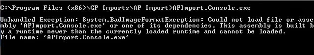

I had run out of ideas. I finally tried testing via the Command Prompt window to see if I could get any additional error info.
Hmmm, this additional information would seem to indicate that the problem is a .NET version issue, and not a typical 32 vs. 64 bit conflict.
Unhandled Exception: System.BadImageFormatException: Could not load file or assembly 'myapp.exe' or one of its dependencies. This assembly is built by a runtime newer than the currently loaded runtime and cannot be loaded.
