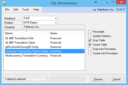

The HITB tables should be cleared out in order for the process to be comprehensive and complete.
  • Go to ( Dynamics GP > Maintenance > SQL )
  • Choose the company database
  • Under product, choose “HITB report”
  • Highlight the “Inventory Transaction History Detail”
  • On the right side, check the options to “drop and create table”
  • Process
SQL Maintenance
drop data HITB
Now, the final result for the inventory tables can be seen below, as all tables have been cleared out
Final
