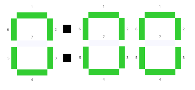

When I first set out to build a digital clock with night mode, I figured I was just going to start from what I know. Each digit of the clock is composed for 7 segments and each segment would behaves in a binary way based on the number that it needs to display.
To create each segment, I would use a Rectangle from the Icons gallery. Since I initially set out to add 3 digits to the clock - two to display seconds, and 1 to display minutes - this would require a whopping 21 rectangles, plus 2 for the blinking dots to bring the total rectangles to 23.

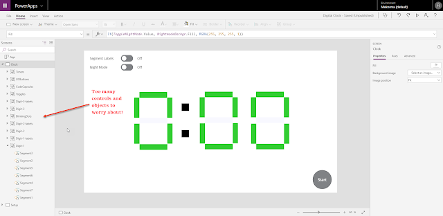

As can be concluded from this exercise, the amount of (repeated) code, variable declarations, and controls increase progressively per 7-segment digit added. Another thing I noticed is, timers are not as responsive and the application is slow, overall - not the type of experience you would like and end-user to have.
NOTE: I am not sure if components is right for every application case, but one thing that I will insist on is to group objects and controls wherever possible to facilitate application readability and control navigation as an app builder.
Here's the final result:
On the positive side, building this application, using the pain staking process above thought me how I could leverage PowerApps components in order to promote code reusability, improve user experience, and increase application responsiveness. That will be the subject of my next article, Part 2 of this series.
