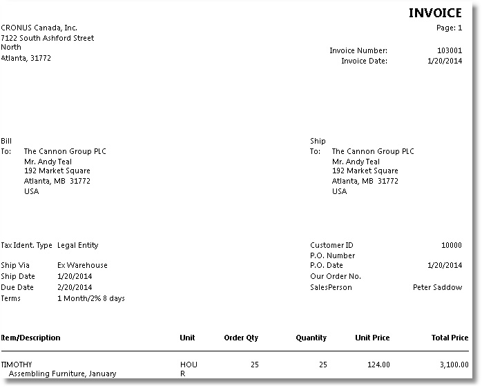

Print Preview (click for larger view):

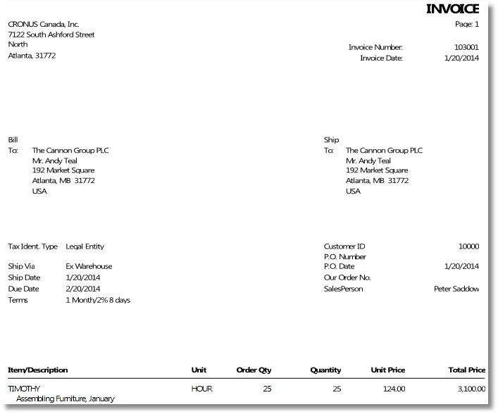

Printed Version:

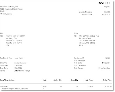

As you can see, the fonts are rendered in a way that messes the spacing up quite a bit.  This report is still fairly readable, but others don't fare as well, e.g., have a look at the Shipment heading:
 Once it's actually printed on paper, it looks worse.
