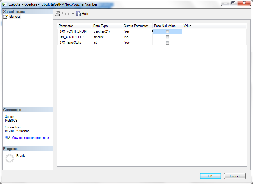

The second challenge with eConnect stored procedures is to determine the parameters that need to be passed in, but all eConnect stored procedures are created with encryption, so editing them was not an option. However, I remembered that in SQL Server Management Studio, you have the ability to execute a stored procedure from the Management Studio UI and that this would in effect display a window with the parameters, furthermore detailing data types and whether they are input or output type parameters.
| Execute Stored Procedure option (Right-click) |
| Execute Procedure window |
USE [TWO] GO DECLARE @return_value int, @O_vCNTRLNUM varchar(21), @O_iErrorState int EXEC @return_value = [dbo].[taGetPMNextVoucherNumber] @O_vCNTRLNUM = @O_vCNTRLNUM OUTPUT, @I_sCNTRLTYP = 0, @O_iErrorState = @O_iErrorState OUTPUT SELECT @O_vCNTRLNUM as N'@O_vCNTRLNUM', @O_iErrorState as N'@O_iErrorState' SELECT 'Return Value' = @return_value GO
