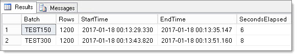

I didn't know if 60 seconds for a 1,200 line JE was fast or slow, so I performed a few tests on one of my development VMs. I created two test batches: One had 150 JEs with 8 lines each, and the other had 300 JEs with 4 lines each. So each batch had 1,200 lines. I then ran this query on my batches:
SELECT MAX(ORGNTSRC) AS Batch, COUNT(*) AS Rows, MIN(DEX_ROW_TS) AS StartTime, MAX(DEX_ROW_TS) AS EndTime, DATEDIFF(ss, MIN(DEX_ROW_TS), MAX(DEX_ROW_TS)) AS SecondsElapsed

As you can see, my test batches showed DEX_ROW_TS elapsed times of 6 and 8 seconds, respectively. So my test JEs appear to have posted significantly faster--up to 1/10th the time as the customer.
It's no surprise that my test in the virtually empty TWO database will show faster times than a large production database, but 6 seconds vs. 60 seconds is a pretty big difference. And having worked with hundreds of customers to automate their Dynamics GP posting processes using Post Master, I am pretty sure that this customer is seeing less than optimal SQL performance, and that I'll be having a few more support calls with them in the future.
