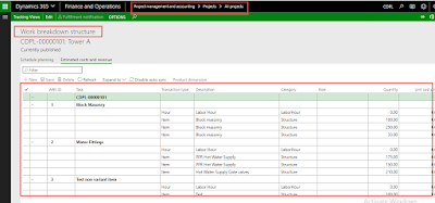

Recently I have a requirement of importing the work breakdown structure lines on request for quotation lines as per associated project. So for achieving the requirement I have develop a job that can get the WBS lines and import those line on RFQ using AxPurchRFQCaseLine class. Please see below screenshots.
Work break down structure lines which needs to be imported:

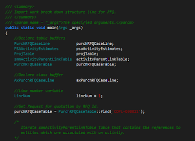

Source code of a method which breakdown in three images:
Image 1.1:
Explanation of below source code image:
  • Initialize tables, class and edt buffers.
  • Get RFQ. (Here I have hardcoded RFQ Id)

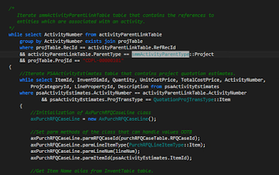

Image 1.2:
  • Query to iterate smmActivityParentLinkTable table that contains the references to entities which are associated with an activity.
  • Sub query to iterate PSAActivityEstimates table that contains project quotation estimates.
  • Declaration of AxPurchRFQCaseLine class.
  • Set OOTB Parm methods of the class that can handle the given values.
Image 1.3:
  • Save method of AxPurchRFQCaseLine class that inserts the records also runs all the possible validations for request for quotation lines.
