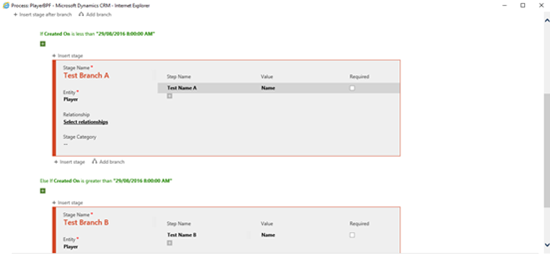

While testing I was able to determine that this error would appear for two different cases. The first being whenever I used a Business Process Flow which contained branches with an else/if condition. If a Business Process Flow contained this condition, then the error would show whenever I attempted to add an existing process.
I also noticed that this error would not occur if the branches had an if and an else condition, so only if/else would cause it. It is worth noting that the error would only show for solutions that contained Business Process Flows with these if/else branches, so solutions without these Business Process Flows were free to add existing processes.
