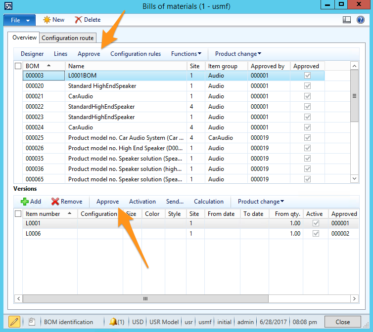

This is a somewhat strange parameter in execution though. In order to remove approval, the approval has to be removed from the top level of the BOM at Inventory management > Common > Bills of materials.
Notice there are two places to approve a BOM in this form.
As you can see in the image, there are two levels of approval in this form. The top one is the one that needs to be removed in order for this to work.
If you access a BOM on a Released product under Lines in the Engineer tab and try to remove the approval, it won't work. The BOM can be re-approved there, but the approval cannot be removed at this level.

Once the approval is removed from that top level in the BOM form in the Inventory management module, the BOM can be edited as desired. This process will keep BOMs from being accidentally edited, changed, or deleted.

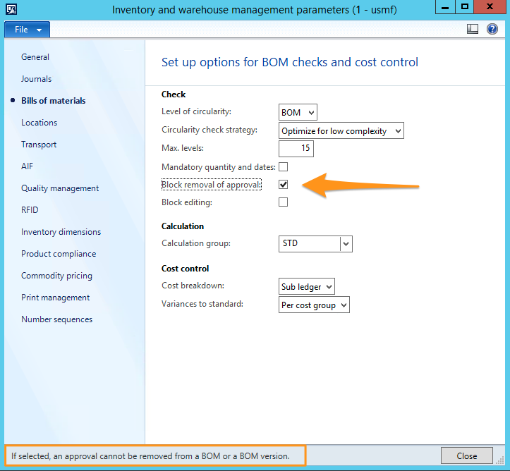

In Inventory management > Setup > Inventory and warehouse parameters > Bills of materials, there is another checkbox called Block removal of approval.
The Block removal of approval parameter is available in Inventory and warehouse management parameters
Block removal of approval, when selected, will not allow anyone to remove an approval from a BOM.
It states "If selected, an approval cannot be removed from a BOM or BOM version." The only scenario I can imagine this working well for is if a company uses a BOM for a certain period of time and puts an expiration date on it, then transitions to the next approved BOM after the expiration date has passed.
Using this method would keep a solid history of BOMs that were used during certain time periods and you would know that the BOM had not been adulterated at any time during that period because of this parameter.
