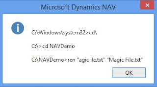

Now Let's try to execute the codeunit and see the results.
Command := 'C:\NAVDemo\autonav.bat';
ExecuteBat := ExecuteBat.ProcessStartInfo('cmd', '/c "' + Command + '"'); //Provide Details of the Process that need to be Executed.
ExecuteBat.RedirectStandardError := TRUE; // In Case of Error the Error Should be Redirected.
ExecuteBat.RedirectStandardOutput := TRUE; // In Case of Sucess the Error Should be Redirected.
ExecuteBat.UseShellExecute := FALSE;
ExecuteBat.CreateNoWindow := TRUE; // In case we want to see the window set it to False.
Process := Process.Process; // Constructor
Process.StartInfo(ExecuteBat);
Process.Start;
ErrorMsg := Process.StandardError.ReadToEnd(); // Check Error Exist or Not
IF ErrorMsg <> '' THEN
ERROR('%1',ErrorMsg)
ELSE BEGIN
Result := Process.StandardOutput.ReadToEnd();// Display the Query in the Batch File.
MESSAGE('%1',Result);
END;
** This image is for the Demo purpose you can remove the Else part of the ErrorMsg if you don't want the popup.

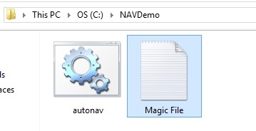

Let's check the folder to see our file is renamed or not.
