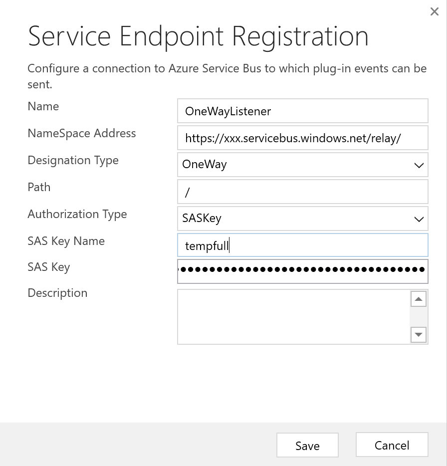

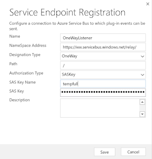

Then we head over to the plugin registration tool, connect to our organization and add a new service endpoint. This time it'll look kind of like this when it's filled in:
What's important to note here is the namespace address and path. The namespace address should be the complete path, and the path should just be a forward slash (the tool does not accept blank values). If you specify the path in the path box then it won't be able to find and connect to your relay service (that took me a while to figure out). In addition, this is an https endpoint, not an sb endpoint

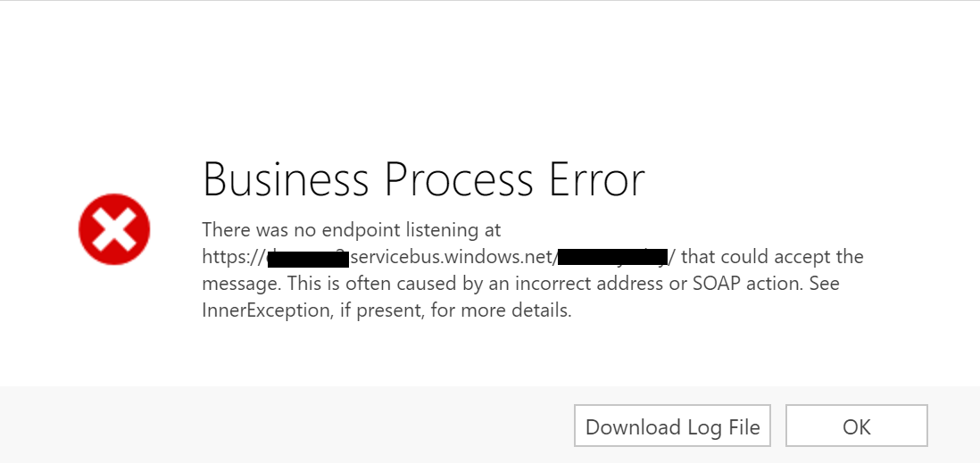

Now, just to demonstrate how it looks if you've specified the wrong endpoint, or if the relay isn't running, here's the error message you get. It is the same error you'll get if you specify the path in the path box instead of in the namespace box.

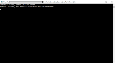

Now, for the fun part instead. Start your relay service and wait for the host to be ready. Then go into CRM and trigger the plugin. If you've done everything right then you'll see a command window looking something like this
And that means we've successfully posted a message from our MSCRM system, through our azure service bus and out of the relay service. This example isn't very exciting, but just think of the possibilities you get if you put this service out into Azure (or on a web server if you're still into that whole old school infrastructure stuff ;) ).
