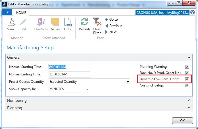

The dynamic low-level code is something that is activated by a checkbox in the Manufacturing Setup table.
Dynamic-Low-Level-Code-Dynamics-NAV
When using the dynamic low level code functionality Dynamics NAV updates the codes in the item table each time a production BOM is certified or added to an item. The dynamic low-level code could have an effect on the performance of the certification process. I have seen Dynamics NAV solutions with so many production BOMs and items (> 100.000) that it was not possible to use the dynamic low-level code. Another reason to turn this off is when you migrate production BOMs into Dynamics NAV, instead of having the low-level codes to be calculated for each of the production BOM that is certified it is much quicker to certify them all without the dynamic low-level code and then afterwards run the batch job described below.

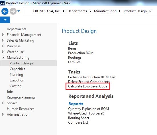

This is a batch job that runs through all the items and calculates the low-level codes.
Calculate-Low-Level-Code-Dynamics-NAV
Even if you have the dynamic low-level code activated it is recommended that you run this batch job from time to time, especially if you are making lots of changes to production BOMs on a daily basis.
I always recommend that you run this before you run any MRP job. The reason for this is that the dynamic low level code functionality in Dynamics NAV is not completely accurate; if you for example delete a production BOM the low-level codes of the components are not recalculated. If you run your MRP or the cost adjustments as scheduled activities, then just schedule this batch job to run before and you should be fine.
