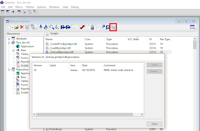

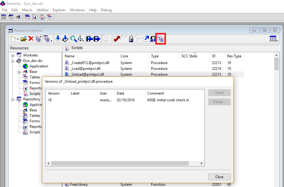

Version Information Crash
Typically, and under normal circumstances, you should be able to click on the version information button and obtain the changeset version history of a particular resource in the repository. In our case, clicking on this option would crash Dexterity.
Digging a bit into the issue, we realized that all changeset versions causing Dexterity to crash seemed to have values above 9,999 -- we looked at this through Visual Studio as Dexterity was, well, crashing.
Apparently, during the migration to VSTS, changesets get new version information, although our changeset dates remained intact. This would make sense as the migration from TFS 2012 to TFS 2013 did the same. Our assumption here is simply that Dexterity's version information was never designed to handle changeset values above 9,999 and that would explain why it's crashing.

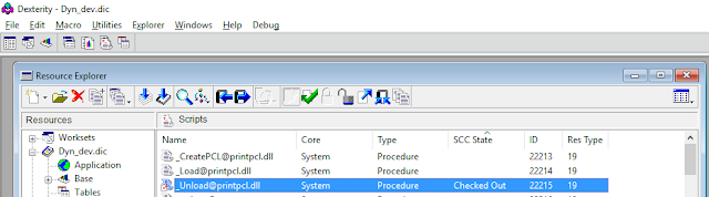

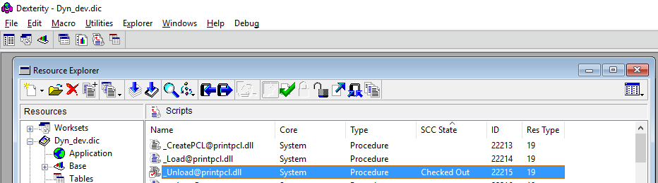

Another issue we found is, whenever a developer checks a resource out of the repository and attempts to inquiry the status of that resource in the repository, Dexterity crashes also. The following shows a resource checked out from the repository:
