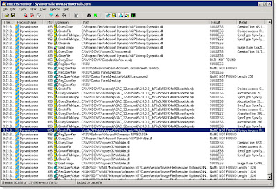

The client finally had a streaming session with the support engineer who eventually used the Process Monitor tool to trace the behind the scenes GP activity. In the 137,000 records that scrolled by, the engineer eventually found a strange error.
Dynamics GP was getting a path not found error when trying to read and write to the AddIns folder. What was strange was that the path that was listed in the Process Monitor log was \\remoteserver\data\Apps\GP9\Dictionaries\AddIns.
The very sharp engineer then took a look at the client's Dynamics.set file. Everything looked normal, except for one line. The Dynamics.dic file path was set to the same network share as the Reports.dic and Forms.dic. For some reason, the client's IT staff had made the Dynamics.dic a shared dictionary.
Putting the two together, he noticed that Dynamics GP was looking for an AddIns directory in the same location as the shared Dynamics.dic file. He, and I, thought (assumed?) that GP looked for the AddIns subdirectory in the same location as the Dynamics.exe and Dynamics.set, but apparently this is not the case. It seems that GP expects the AddIns subdirectory to be in the same directory as the Dynamics.dic file. Normally, the Dynamics dictionary is located in the local GP application directory, and there is no reason to share it, so that statement is usually true--but only by coincidence.
Having deduced this much, they modified the Dynamics.set file to point to the local Dynamics.dic, and viola, the AddIns suddenly started working.
