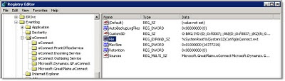

I didn't want to figure out if the eConnect installation created the event log, or whether a call to eConnect would create it on the fly--I just wanted to create the registry entries and get the log setup. Rather than trying to manually create registry keys, I dug through my pile of virtual servers and found an old one that had a GP 9 and GP 10 installation, with both versions of eConnect. That server had an eConnect event log, and corresponding registry entries.
So I exported the eConnect key from HKEY_LOCAL_MACHINE\SYSTEM\CurrentControlSet\Services\Eventlog to a .reg file, copied that to my problem server, and imported the .reg file.
Like magic, the registry access error went away, and I was able to get the actual eConnect error for the data I was trying to import.
