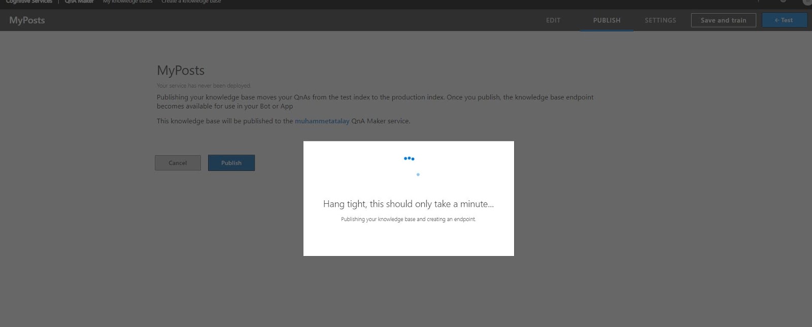

Publish
You have to publish it before expose it to the internet. Click Publish from top of the windows then click again from the new window to be displayed. It may take some time to complete.
Publishing Knowledge Base
Once publishing completes you will get following screen. We are going to use config. keys while using the service in my blog page as a widget.

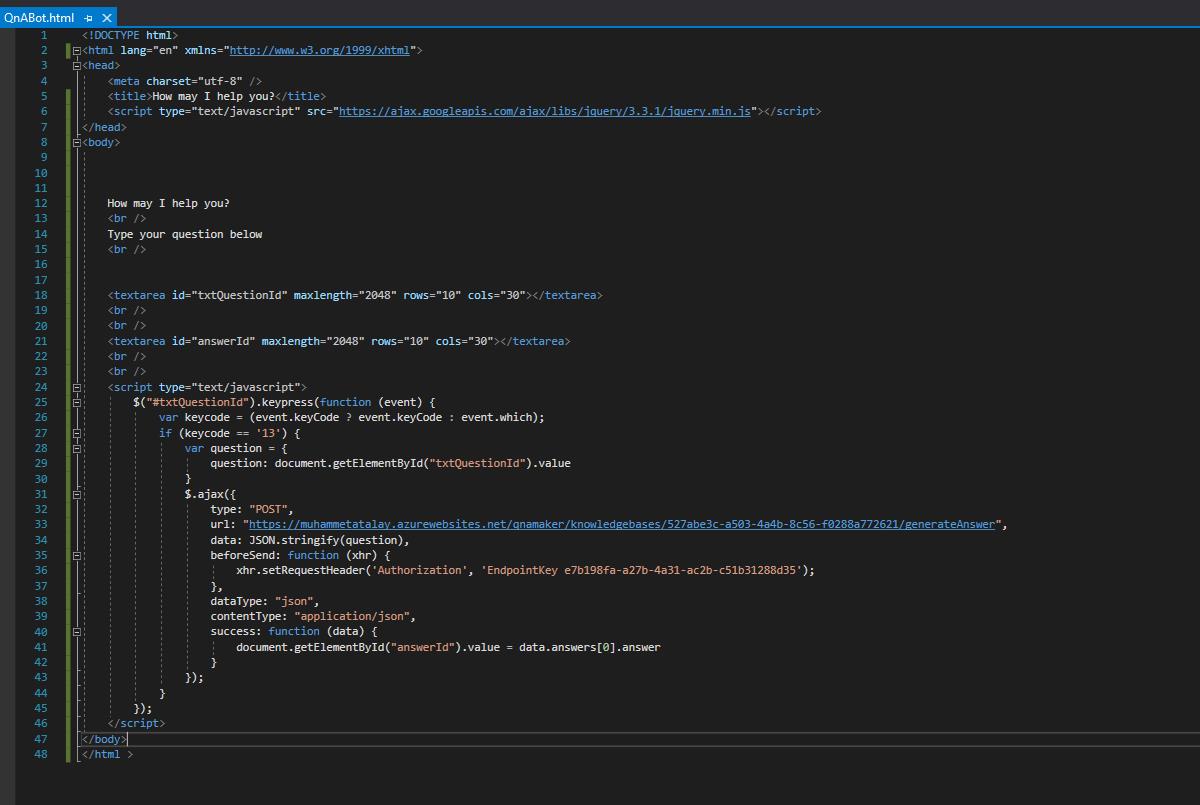

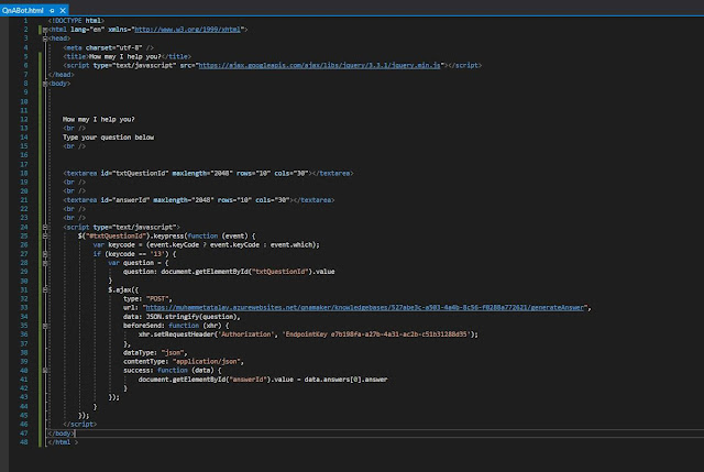

Caller creation in HTML for widget
Our service is ready to answer any questions regarding posts at my blog page. We have already got necessary connection string(s), credentials detail and response in JSON as seen just above.
I am going to create a html page to send question to and receive answer from MyPosts KB under QnA Maker service.
I use jquery to send request and get response.
Service responds back JSON object that contains answer of the question the best possible one in the Knowledge base.
In order to increase quality of answer we should train it properly and feed it with well format input.
Here is the code snapshot;
QnABot.html
 <!DOCTYPE html>
<html lang="en" xmlns="http://www.w3.org/1999/xhtml">
<head>
<meta charset="utf-8" />
<title>How may I help you?</title>
<script type="text/javascript" src="https://ajax.googleapis.com/ajax/libs/jquery/3.3.1/jquery.min.js"></script>
</head>
<body>
How may I help you?
<br />
Type your question below
<br />
<textarea id="txtQuestionId" maxlength="2048" rows="10" cols="30"></textarea>
<br />
<br />
<textarea id="answerId" maxlength="2048" rows="10" cols="30"></textarea>
<br />
<br />
<script type="text/javascript">
$("#txtQuestionId").keypress(function (event) {
var keycode = (event.keyCode ? event.keyCode : event.which);
if (keycode == '13') {
var question = {
question: document.getElementById("txtQuestionId").value
$.ajax({
type: "POST",
url: "https://muhammetatalay.azurewebsites.net/qnamaker/knowledgebases/527abe3c-a503-4a4b-8c56-f0288a772621/generateAnswer",
data: JSON.stringify(question),
beforeSend: function (xhr) {
xhr.setRequestHeader('Authorization', 'EndpointKey e7b198fa-a27b-4a31-ac2b-c51b31288d35');
dataType: "json",
contentType: "application/json",
success: function (data) {
document.getElementById("answerId").value = data.answers[0].answer
</script>
</body>
</html >

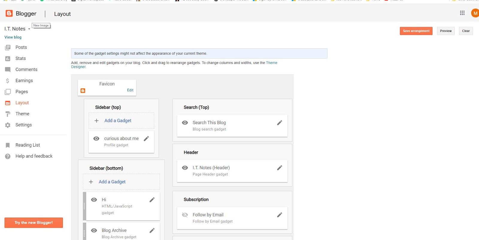

I am using blogspot.com for my posts and I bind domain name of mine to the post through settings in blogspot.com.

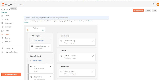

  • Open your blogspot.com panel - Important Notice : not all templates support widget, find proper one if needs.
  • Go to Layout section from the page.
Layout

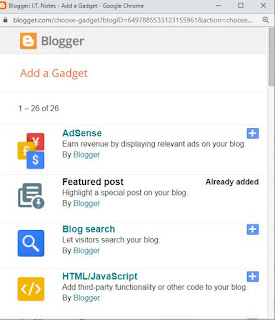

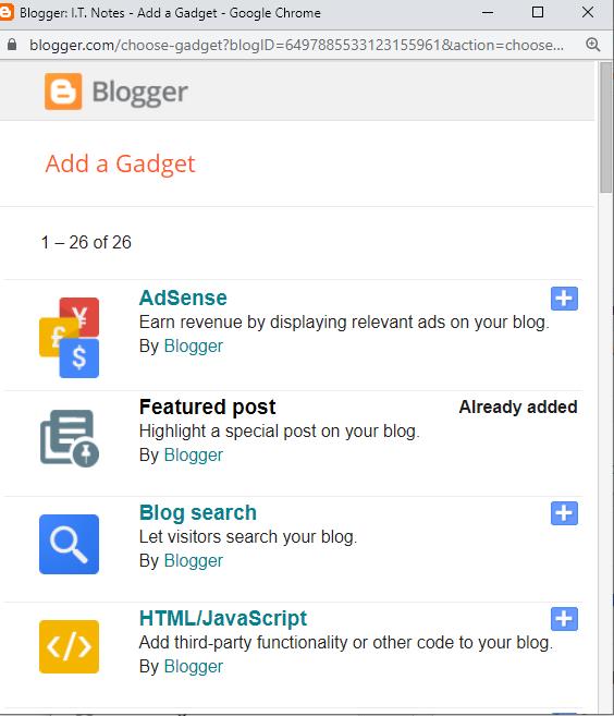

  • Click "Add a Gadget" then choose HTML/Javascript from popup window
Adding a Gadget

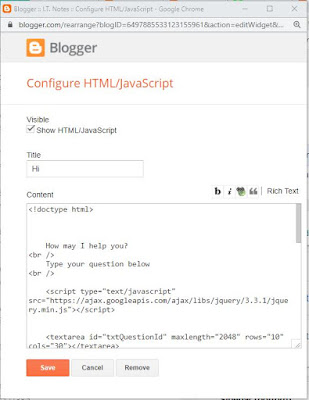

  • check Visible for "Show HTML/Javascript" then add title
  • Paste html code of above to the Content.Finally click "Save"
Configuration panel of HTML/Javascript
  • Click "Save arrangement"
