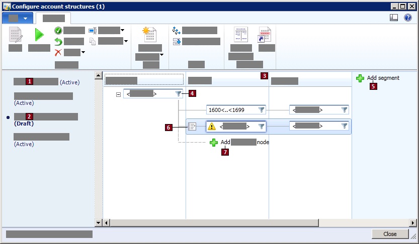

Configure account structures form (in Ax2012):
The "Configure account structures" form is used to create the Account structures. As mentioned above, Account structures consists of 'Main Accounts' and can include 'financial dimension' segments. So in this form, we need to define the valid combinations, which together with the main accounts, form (become) a Chart of Accounts (COA)
In the "Configure account structures" form, the whole account structures can be viewed in the below ways.
Path: General Ledger > Setup > Chart of account > Configure account structure
Account structure elements: (showed in the above snapshot)
Below are some Account Structure terms and definitions.
- Horizontally - View the columns that show the dimensions that make up the structure.
- Vertically - View the hierarchical visualization of the rules that describe how the combinations behave.
- Active account structure
- Draft account structure
- Account structure segment
- Filter button
- "Add segment" button
- Action menu
- "Add %1 note" button
- Account structure: A structure that defines the valid combinations of main account and dimension values.
- Segment: is each column in the Configure account structures form. Segments consist of main accounts or financial dimensions.
- Filter button: A button that opens the 'Which values are allowed for the %1 field' form, where you can specify the values that are allowed for each segment.
- Action menu: A menu icon that is displayed next to segment rows. Click the Action menu to set active dates and to copy, paste, delete, or move segments.
- Combination: The arrangement of account segments, advanced rules, and criteria.
- Advanced rule: A relationship principle that helps make sure that dimension values are entered correctly, and are filtered and validated according to the dimension structure. Advanced rules are defined for each account structure.
- Financial dimension: An attribute that additionally defines an entity.
- Ledger account: The combination of main account and other dimension values, as defined by the chart of accounts, and which classifies financial activity.
- Main account: The type of record—asset, liability, revenue, expense, or owner’s equity—that is used for recording individual transactions in an accounting system.
