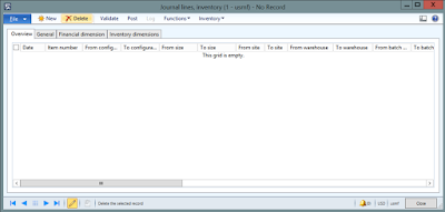

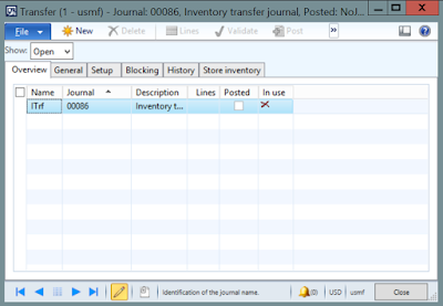

1.Go to inventory management --> Journals --> Item transactions --> Transfer
2. Add journal name --> Click on Lines
3. Add Item number

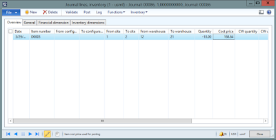

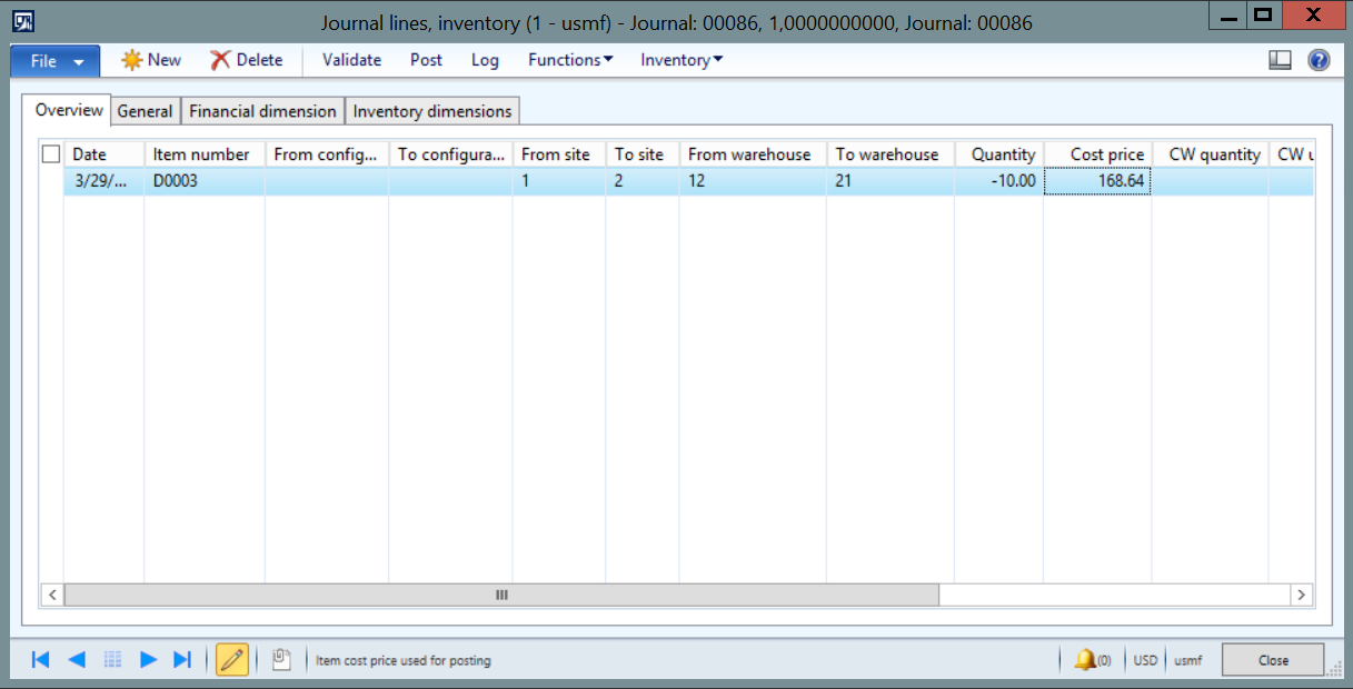

7. Here in this journal, we are transferring the item D0003 between Site1/Warehouse 12 to Site2/Warehouse 21 so,
 a. Item Number: D0003
 b. From Site:1 / From Warehouse: 12,
 c. To Site: 2 / To Warehouse: 21
 d. Quantity: -10.
 d. Other dimensions (From and To configuration, Size, color etc) will be as it is.

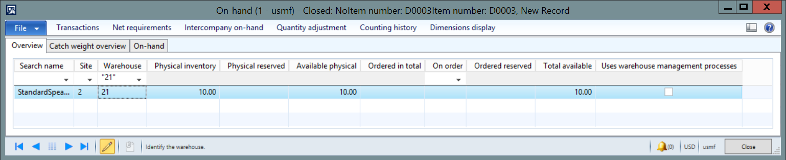

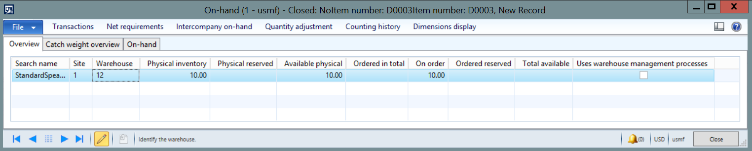

Note: Before the transfer, the On-hand inventory for the item D0003 at the Site1/Warehouse 12 was 10.

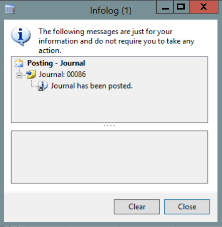

7. Now Validate and Post the Journal.

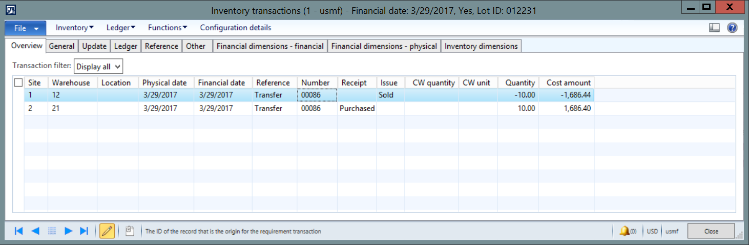

8. Check the On-hand inventory, you can see 10 quantity is transferred from Site1/Warehouse 12 to Site2/Warehouse 21
9. Check the Inventory transactions (Transaction status is 'Sold' for Site1/Warehouse 12 and 'Purchased' for Site2/Warehouse 21)
