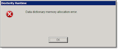

Because I work a lot with Post Master Enterprise, which occasionally requires manual adjustments to the Dynamics GP Dynamics.SET file, I pretty consistently get a question about this error message.

The Data dictionary memory allocation error shown above is very easy to fix. It indicates that the module count listed on the first line of the SET file does not match the number of modules listed in the SET file. So if you have to manually edit the SET file to remove one module, you need to decrease that module count by one. If you get this error message, it's a 10 second fix.
