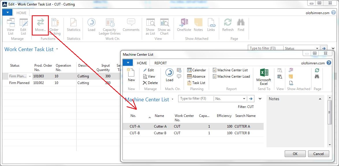

When you create your routing for operations that take place on work centers like this you have the option to create it with a specific machine center or with the more generic work center. This option is very useful, you could for example have all the routings defined with the cutting work center which Dynamics NAV then uses for the initial scheduling and creation of production orders (yes NAV considers the production orders scheduled on the machine centers as a load on the work center as well in this case). Once the start date of the production order gets closer a user can go through the task list on the work center and assign the tasks to the individual machine centers using a move function. The move function let a user select a machine center within the work center to move an operation to.
Move-Function-Work-Center-Task-List-Dynamics-NAV
The tasks left on the work center are then tasks that are due to be assigned to a machine center (since they fall of the task list of the work center when they are moved to a machine center).

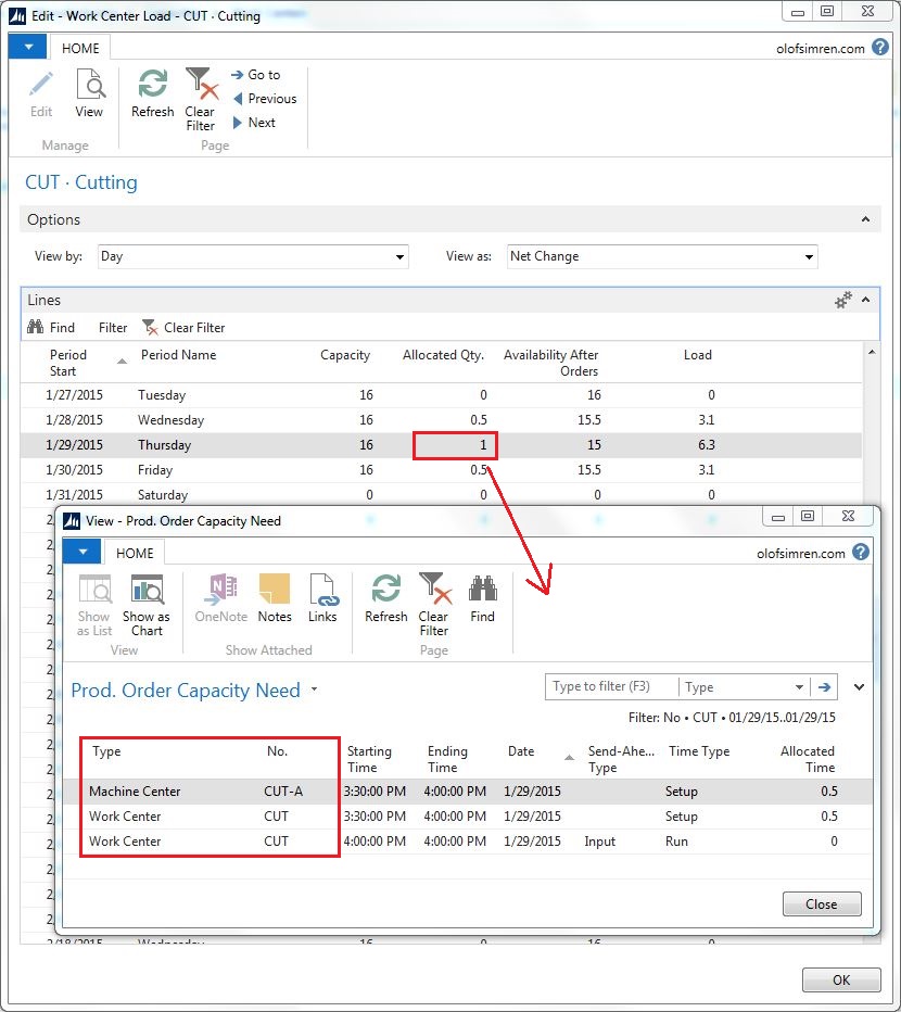

The load on the work center still shows the total allocated time even if the task is moved to a machine center. Drilling into the allocated qty. field then shows the details about if the time allocated is towards the work center (e.g. non-delegated operation) or towards a machine center.
Work-and-Machine-Center-Load-Dynamics-NAV
So this way you can manage the load on two levels; as a total on the work center or for each individual machine centers.
