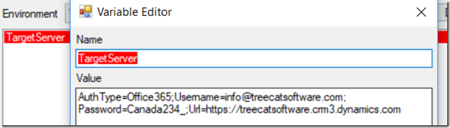

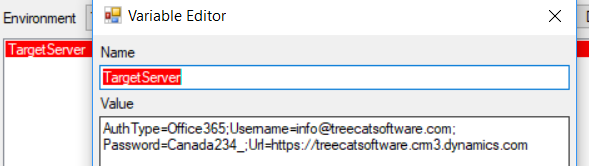

  • From the Package menu, open “Variables Editor”, select “qa” environment, and update the connection string:image
