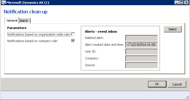

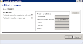

When I first started cleaning up alerts in my AX environment, I had a reminder in my calendar to clean up alerts every Friday and I would set it with the following parameter so that it would clean up alerts from three weeks prior and older.
Screenshot of Notification Clean-up with parameters set: Alert created date and time <"12/19/16 01:00:00 pm"
Imagine I am running this today to clean up everything older than three weeks in EventInbox.
