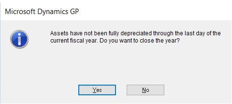

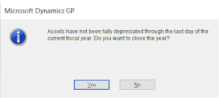

The most common reason for such a case is to close the fixed asset year before all assets have been fully depreciation. Despite of the fact that the system usually pre-check whether all assets have been fully depreciated when the year end closing procedure is run, the end user can still ignore that warning and proceed with the closing procedure.
Here is the warning which pops up when running year-end closing before depreciating all assets:
| Year-end closing Warning |
