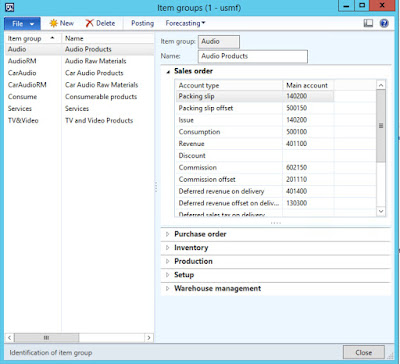

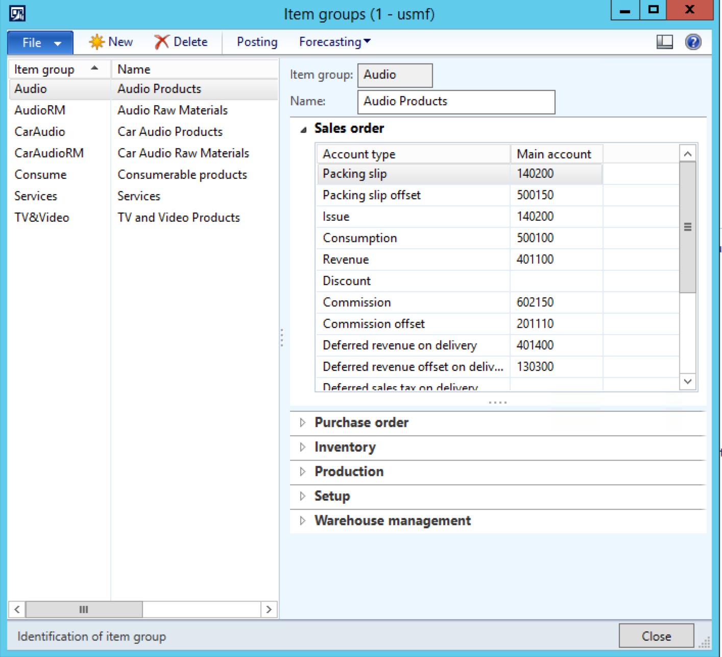

Item group
Setup for the Item group can be found in the Inventory management module under Setup > Inventory > Item groups.
Item groups are used to divide inventory items into groups and assign a posting setup that might be different from the standard posting profile. This can really allow a company to differentiate between many different item types and then later report on items within these Item groups and their specific accounts.
Item groups form in AX
Item group setup in AX
As you can see, there are specific accounts set up for the Sales order, Purchase order, Inventory, Production, Setup, and Warehouse management functions related to these items.
When you open each tab, you will see a listing of account types and it is here that you can specify a special account type for financial posting of an item during any of the functions listed.
Typically, Item groups are created based on a particular grouping of similar items within a company. For example, in the screenshot above we have Audio Products, Audio Raw Materials, Car Audio Products, Car Audio Raw Materials, Consume, Services, and TV & Video. You can name them whatever you want, but my recommendation, just as with Item model groups, is to set the name to something that will make sense to the people who will be creating items. Do you have a certain ingredient that needs to be accounted for differently? Name one after that ingredient! The possibilities are endless.
