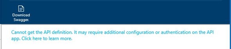

In trying out the new Azure API apps by converting an existing ASP.NET Web API, you can run into this error as soon as you publish your API to azure for the first time and check out the API definition blade:
Trying to add the API as an Azure App client can get you nicer errors like: "Found operation objects with duplicate operationId 'Contacts_Get'". or worse just Bad Request errors. So what does this mean?
