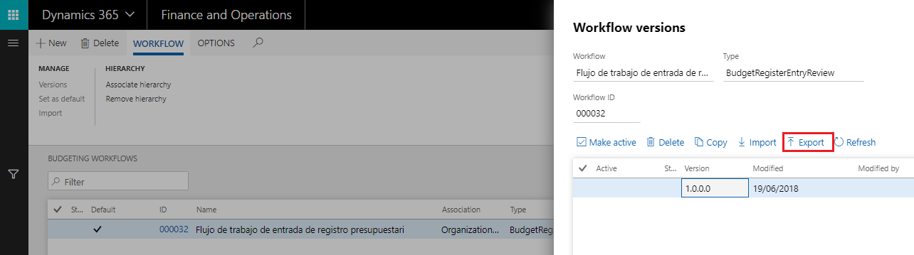

D365FO has a possibility to export workflows enabling you to move your workflow configuration from one environment to another.
Recently I have encountered a couple of issues with it. Couple standard workflows exported perfectly except a custom one.
