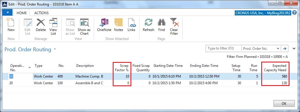

The scrap factor % is setup in the routing line.
Scrap-Factor-Percent-on-Routing-Dynamics-NAV
When the production order is created the value of the Scrap Factor % field from the routing line is transferred to the Scrap Factor % field of the production order routing and the capacity need for the operation is increased accordingly.
Scrap-Factor-Percent-on-Routing-Routing-Dynamics-NAV
The related components quantities are also increased accordingly.

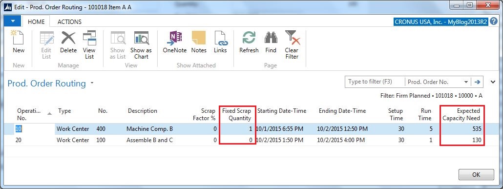

You set this up in the Fixed Scrap Quantity field on the routing.
Fixed-Scrap-Qty-on-Routing-Dynamics-NAV
When the production order is created the value of the Fixed Scrap Quantity field from the routing line is transferred to the Fixed Scrap Quantity field of the production order routing and the capacity need for the operation is increased accordingly.
Fixed-Scrap-Qty-on-Routing-Routing-Dynamics-NAV

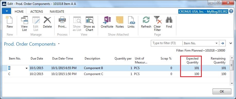

Fixed-Scrap-Qty-on-Routing-Components-Dynamics-NAV

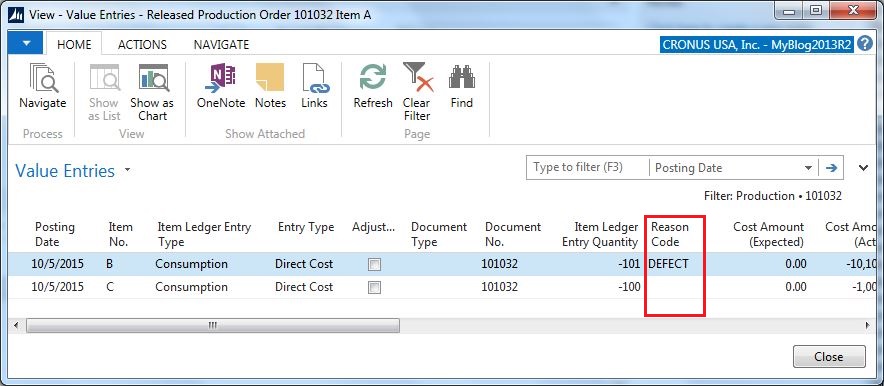

If you want to record why you consumed more than expected then there is a reason code field that could be used. The reason code field is a field that is not in the journal by default so if you want to use this field you need to add it (in standard Dynamics NAV the reason code is setup against a journal batch instead of for each line, but just adding the field to the journal works good).
Production-Journal-Consumption-Reason-Code-Quantity-Dynamics-NAV
The Reason Code goes onto the value entries when the journal is posted and can be used to analyse reasons for scrap.
Value-Entries-With-Reason-Code-Dynamics-NAV

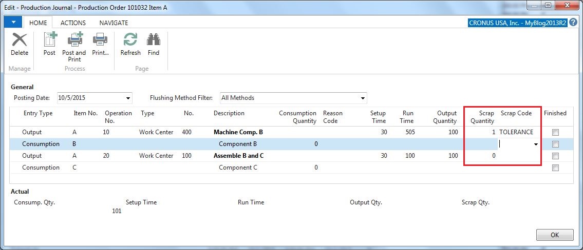

For posting of the operation outputs Dynamics NAV has two fields, output quantity and scrap quantity. It is important the quantity of the good parts and the scrap parts are separated when posting the output. The output quantity is obviously the quantity that goes into stock (if it is the last operation) and carries all the production costs, while the scrap quantities are only recorded against the operation on the capacity ledger entries.
For output you also have a Scrap Code field where you can select a code to record the reason for the scrap.
Production-Journal-Output-Scrap-Code-Quantity-Dynamics-NAV
The Scrap Quantity and Scrap Codes goes onto the capacity ledger entries when the journal is posted and can also be used to analyse reasons for scrap.
Capacity-Ledger-Entries-Scrap-Code-Dynamics-NAV
If you are back flushing your components (see previous post related to Flushing Methods) then the quantity of those are based on the output quantity plus the scrap quantity, so it is important to enter the scrap quantities in this case.
