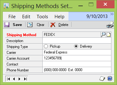

The first that that I did was create a shipping method that would be meaningful for what I am using.  For this example I used Fed-Ex.
Administration -> Setup -> Company -> Shipping Methods
CL_1

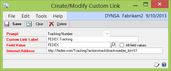

The next step is to create the custom link.
Administration -> Setup ->  Company -> Custom Link -> Then click on New
CL_2
Note:  Once the link is set up, it only works for transaction from the point of creation on.  This is the first problem that I came across.

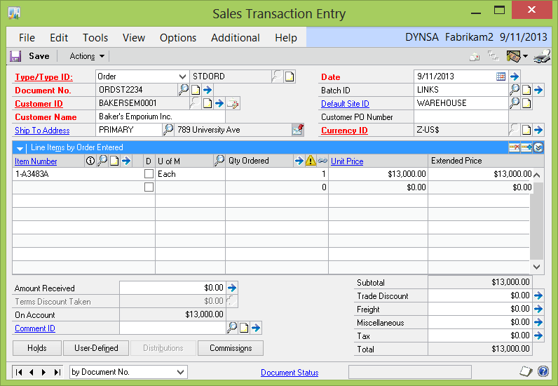

Go to Sales -> Transactions -> Sales Transaction Entry.
CL_3

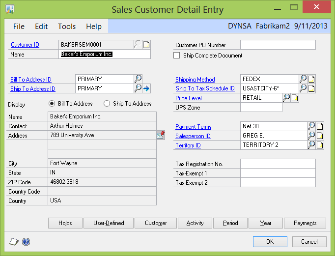

Once the header and item information is filled out you will need to click on the arrow in the Customer ID field.
On that screen you will need to verify that the shipping method is the one that you created with the custom link.
CL_4
Note:  The shipping method defined is for this transaction only.  It does NOT change the Customer Card.

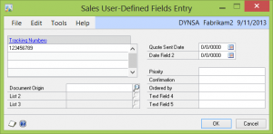

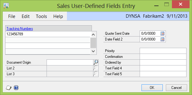

Back on the main transaction window click on the “User Defined” button on the bottom of the screen.  You should then be able to click on the Tracking Number label and a drop-down box should appear with your custom link.
CL_5
