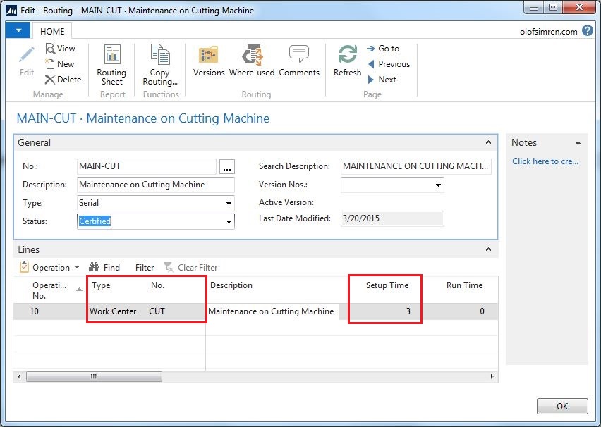

Next we need to define a routing to go onto the maintenance production order. Too keep this simple we just create one with the same number as the item and add one operation on the CUT work center on the on the routing line. For the operation we can add standard tasks, tools, comments, etc. just like with regular routings. I define the setup time as 3 hours since that is what the maintenance will take.
Maintenance-Routing-Dynamics-NAV

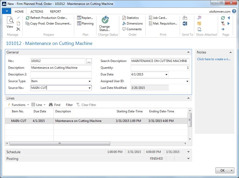

Now you can create maintenance production order as you want (don’t forget to link the routing with the item first). Maybe you want to do maintenance once a month and create them all for the year, or you just want to create them as needed.
You create the maintenance production order same way as if you would create a regular production order manually (e.g. enter the item number, quantity, due date and location then refresh). Typically you want to create it with a quantity of 1.
Maintenance-Production-Order-Dynamics-NAV
