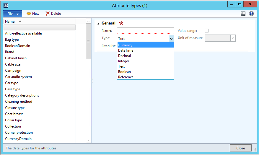

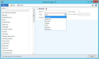

Attribute Types
The Attribute type determines what kind of information will be in an Attribute and how it will be displayed. Attribute types should be set up first.
| Attribute types can be set up as Currency, DateTime, Decimal, Integer, Text, Boolean, or Reference. |
An Attribute type can be set up as a Currency, DateTime, Decimal, Integer, Text, Boolean, or Reference. I am going to create an Attribute type called Range and select Text as my type (I selected Text because the number formats do not allow for symbols and must be utilized in the Value range - more on that next).
| A Fixed list can make your Attribute types a lot cleaner by creating a dropdown of predefined values. |
This is also where you can define a fixed list for your attribute. This will give other users the ability to select the Attribute type from your predefined list instead of typing in a freeform value. If you want to allow for freeform values, you may leave the Fixed list checkbox unchecked.

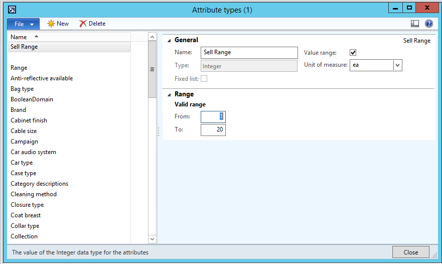

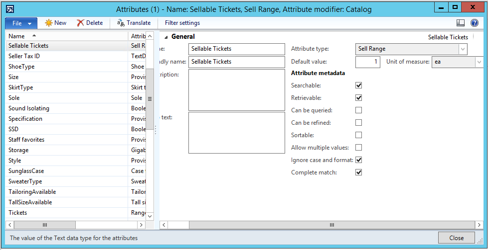

You may have also noticed that there is an option for Value range as well. If I select this, it will give me the option to select a unit of measure and a valid range. Value Attribute types are automatically tied to the Currency, Decimal, and Integer types. In my second example, I will set up an Attribute type called Sell Range that will allow for a selection between the range allotted.
| All number types will be defined by Value range. |
The difference between what I did in the first example versus the second example may be customer driven or a company decision. In the first example, I can select a range between 1-5, 6-10, or 11-15. This is a good option if there are a range of choices. In the second option, I am given a valid range of values to use and select from. I will only be able to select one of those values when I am creating my attribute on the item.

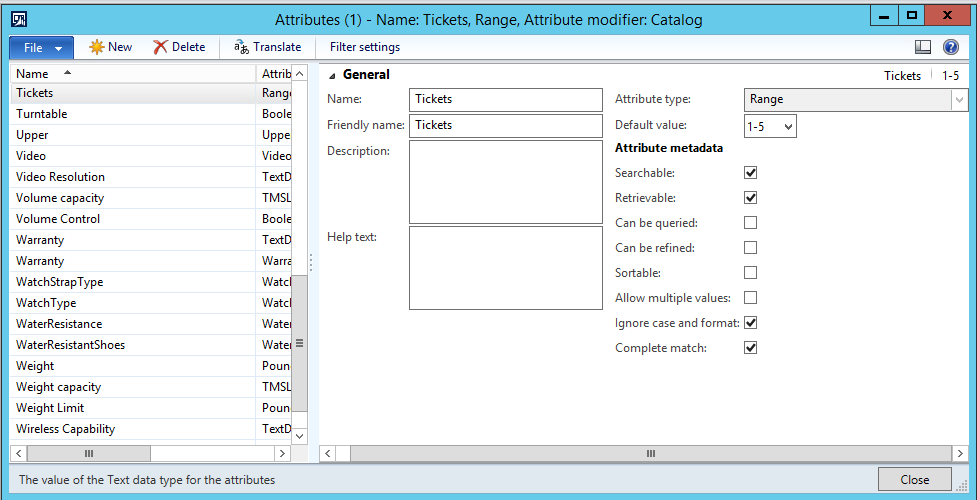

Now that our Attribute type is set up, we must now associate it with an Attribute. I create a new Attribute called Tickets and can now associate my Attribute type of Range with this new Attribute. I can also select a Default value to always populate, for instance, if the typical Range for the Attribute of Tickets is 1-5, I would select that to be my default.
| Setting up a new Attribute, I would associate my Attribute type and select a default value if so desired. |
| An Attribute that has an Attribute type that's a value is set up a little bit differently. |
As you can see, Attributes can additionally be set up to be searchable, retrievable, can be queried, can be refined, sortable, allow for multiple values, will ignore case and format, and allow for complete match. It would be best to keep the selection of these at a minimum if your Attribute list gets lengthy because it may affect system performance.

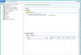

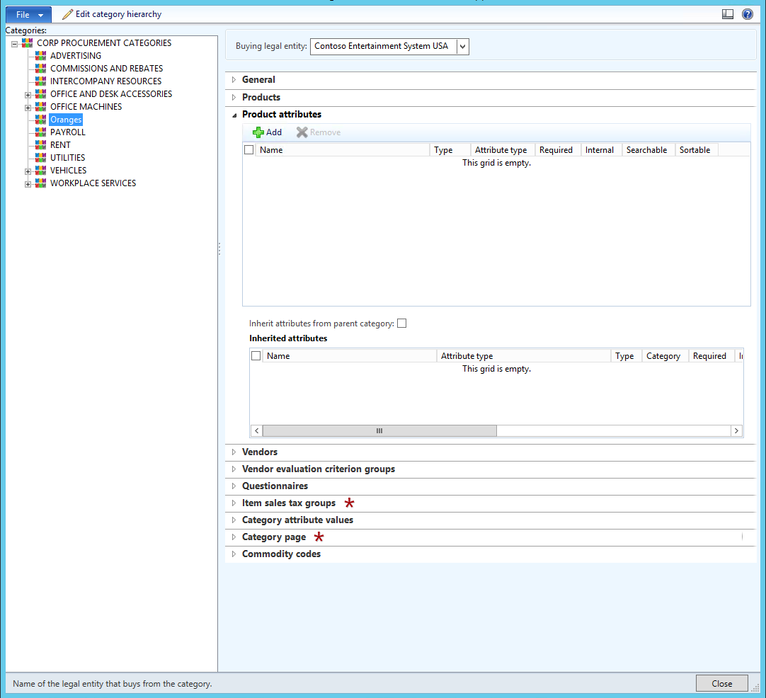

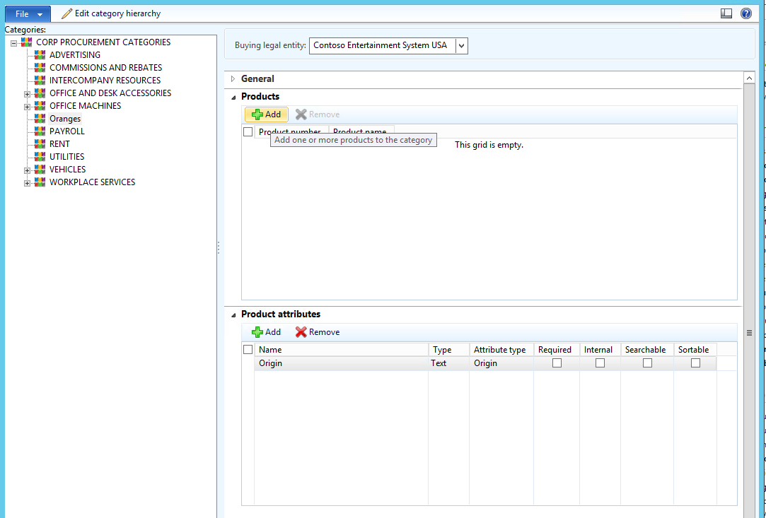

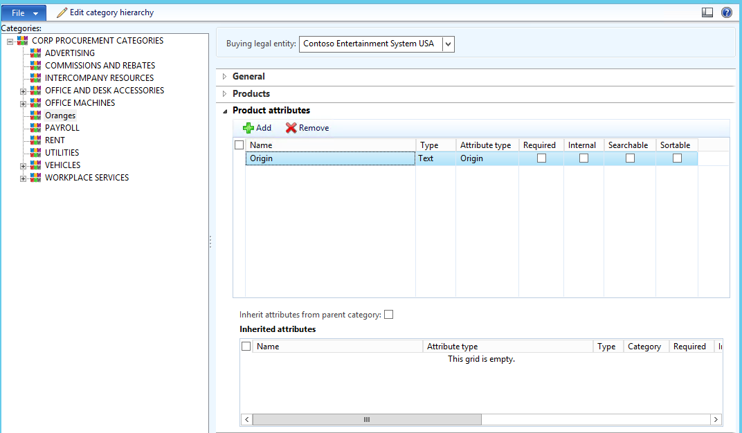

Inside this form, I can create a New category node under the Procurement hierarchy called Oranges for my Attributes associated with oranges.

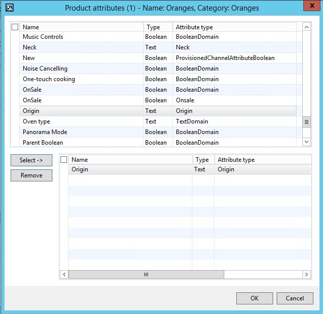

Within my new category of Oranges, I can assign any Attribute under the Product attributes FastTab. In my example, I have selected Origin.

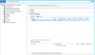

You can now see that Origin is added into my Product attributes within my Procurement category of Oranges. I can also select here whether this is Required, Internal, Searchable, or Sortable.
If I have an Attribute that I want to have available for multiple, or even all categories, I would assign it to the category that is higher in the hierarchy and can choose to inherit category attributes from the parent categories.
Having different categories for different item types allows for the addition of attributes to items within categories that make sense. Because of Procurement categories, I can have the Product attribute Origin on my category of Oranges, the Product attribute of Alloy on my category for Hammers, and if I had an attribute that I used for both, I could just inherit that from the parent.

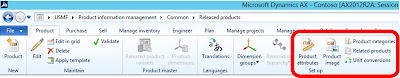

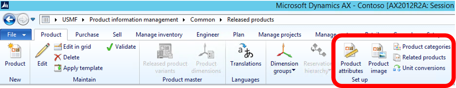

Or, in the Released products form, within the Product information management module, you will select your item. In the ribbon, within the Set up section on the Product tab, you will see both Product categories and Product attributes.

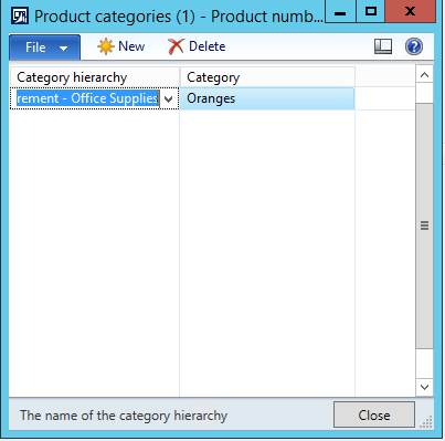

If you select Product categories, it is here where you can select your Procurement category that you set up before. I will be selecting my Oranges category from my Procurement category hierarchy that I created. I will not be able to see any Product attributes on my item until I select a Product category.

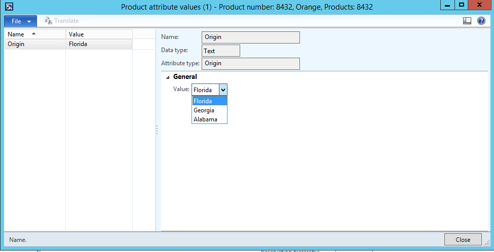

Then, when I open Product attributes on the selected item, I will see that Origin is available as an attribute for me to fill out on this item. The default value is Florida, but the other items from my fixed list have populated as well.
| You can add any Attribute to the Procurement category. |
| Easily select and add any of your Attributes to the Procurement category. |
| The Product attribute of Origin is now added to my Procurement category for Oranges. |

You can add the items themselves in the Procurement category under the Products FastTab. This would be the easiest way to add a category with attributes to multiple items at once.
| Quickly add multiple products to the Procurement category in the Products FastTab. |
| Another option would be to add the items one at a time on the Released products form. |
| Select the Category Hierarchy and the Category to see associated Product attributes. |
| My Product attribute has been added and you can see the fixed list I created for the value of my attribute Origin. |
