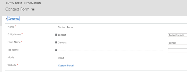

The screenshots above and below show a quick Entity form and Portal Page I created in a trial portal instance against the contact entity.

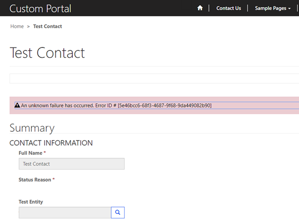

The screenshot below shows the error which is displayed when I attempt to create this record from the portal.

The issue seems to occur when the Status Reason field is required and on the form. Because the Status Reason is a locked field in the Dynamics 365 portal it can’t be populated and hence throws a NullReferenceException error when the form attempts to save with it empty. The screenshot below submits successfully as I have made the Status Reason not required.
