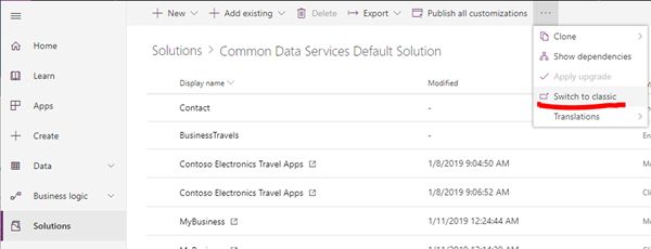

1.     On the welcome screen of PowerApps, Click on ‘Solutions’ on the left-hand side of the screen.
2.     Then click on ‘Common Data Services Default Solutions’, this is where all your Entities will be stored.
3.     You now need to click on the ellipse button on the top of this page which will show a dropdown box containing ‘Switch to classic’, click on this, it will take you to the old ‘Advanced’ page.

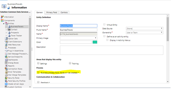

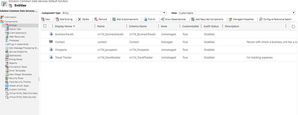

4.     In here, on the left-hand side of the screen, click ‘Entities’ and then click on your Entity. This will bring up an Entity Information screen which includes the setting we need.
5.     On this new screen there will be a check box called ‘Business process flows (fields will be created)’ select this and then press save at the top of the screen. Note: You cannot undo this action.
6.     Finally, publish customisations using the button at the top of the screen.
