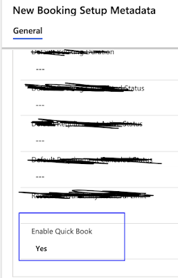

Go to advance find and select the "Booking Metadata Setup" entity and click on the create new record button on the advanced find UI.
Once opened the record and change the value on "Enable Quick Book" to YES. then save the record.

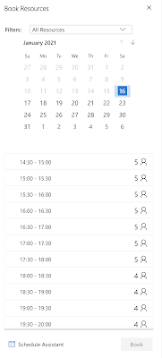

Now go back to the Work Order Entity and try to click on "Book" button then you will be presented with the right window with the available time.
Then you can select the time slot and book the resource accordingly.
