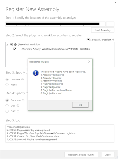

First off I've just specified a simple input parameter for the workflow step. It takes an entityreference of type (logicalname) serviceendpoint, which is the type registered through the plugin registration tool.

And that's it, you've got a working custom workflow step which can be built and uploaded to CRM.

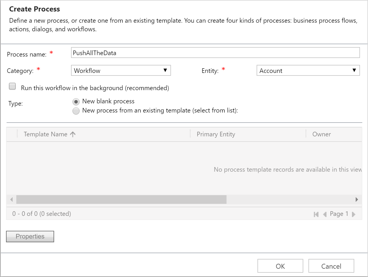

The next step is to start using our new workflow step inside MSCRM. Just go into Settings -> Processes and hit New to create a new process. I like to start out with a synchronous one just to make sure that everything works, and then switch to background when I know it's OK. Even though you can run this step synchronously I wouldn't do it. The network latency alone is enough to make it a bad experience for users, so I would put much effort into using it as a background WF.
I've set the workflow to run on-demand, and then I add our custom workflow action as a step. On the properties-page, search for the service endpoint registered and add that as an input to the workflow step.
Now that we have configured a workflow, go ahead and save and activate it, and we're ready to start populating the ASB with messages.

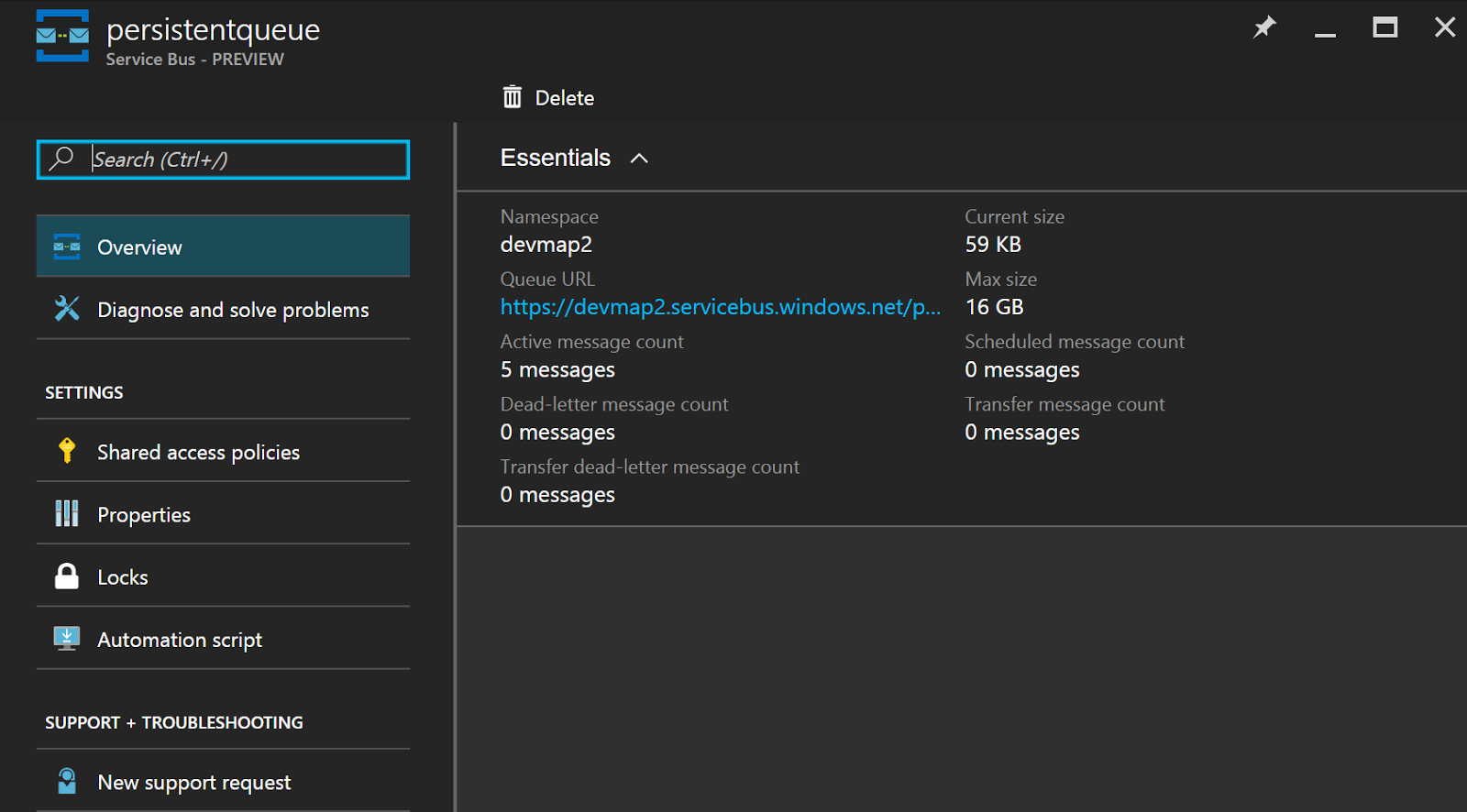

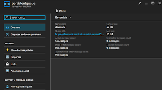

I went ahead and triggered the workflow 5 times, and as you can see from my Azure portal there's messages ready to be processed.
