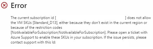

Next, instead of DS12 v2, I tried the default D13, but it did not even let me start the deployment. It gave me the following error:
The current subscription id [subscription id] does not allow the VM SKUs [Standard_D13], either because they don't exist in the current region or because of the of the restriction codes [NotAvailableForSubscription;NotAvailableForSubscription]. Please open a ticket with Azure Support to enable these SKUs in your subscription. If the issue persists, please contact support with this id:[activity id]

The last error was quite clear. The D13 size was not available in the region (West Europe) or not available in the subscription. I rested the case for D13 and focused on the other configuration.
