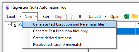

Once you setup everything and load the test cases you can generate the parameter files for your tests.

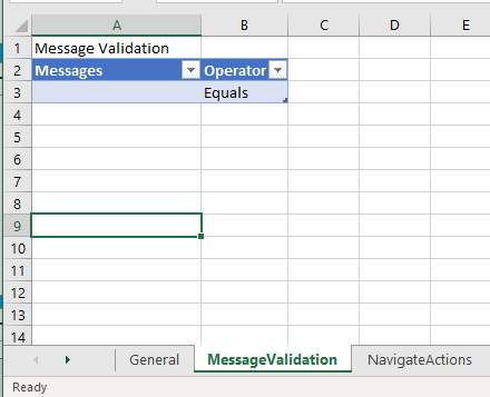

In the parameter file, there is a tab called MessageValidation.
There is a column called Operator. But the only example is Equals.
What are the other options? I did not find a documentation of those.
Equals test only if the message is exactly like you specify.

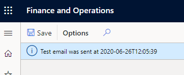

So if you were to test the message bellow, you cannot do that.
There is a fixed part and a variable part. How do I test if the message starts with something fixed?

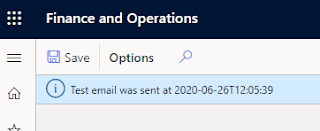

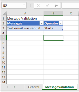

This is how I found out the options.
I changed Equals to something I would expect as an option.

So the options are: Equals, StartsWith and Contains.

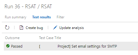

Once I've changed to StartsWith the test has passed.
