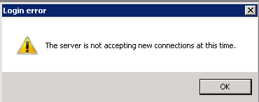

Once you click Reject new clients, the Status field will read Draining, and users will no longer be able to make a new connection to the AOS and they will see the following message when trying to log in:
Screenshot of infolog users see when trying to access draining AOS

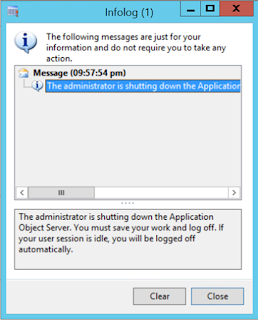

The process of draining automatically takes care of this for you. Instead of going into the Client sessions tab of the Online users form and manually ending sessions (also a valid option, but also a good way to make enemies), users are now given an infolog letting them know that the system administrator is shutting down the AOS. The full text of the infolog states, "The administrator is shutting down the Application Object Server. You must save your work and log off. If your user session is idle, you will be logged off automatically."
Screenshot of infolog alerting users that the AOS is being shut down by the administrator.
"In your face" alerts work much better than company-wide emails.
This alert will pop up after five minutes. After idle for two minutes, the user will automatically be forced off the AOS.
