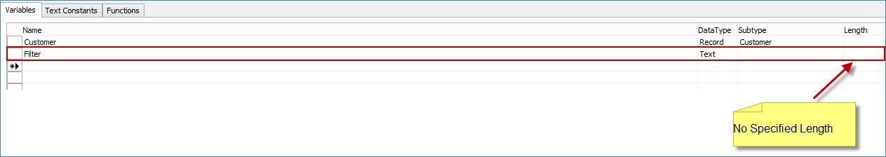

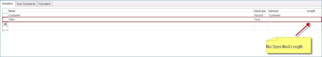

Variable Declaration
Filter Variable
I have got the error as shown in below snapshot when size of my variable Filter exceeded its length.
Error
Error Limit
Case Generation
1) Compilation Error - Give Static Value in variable exceeding its limit.
2) Run Time Error - A variable is assigned values based on certain logic and its limits exceed.
So if we are using a Text variable without specifying its length we can filter out almost maximum number of records.
