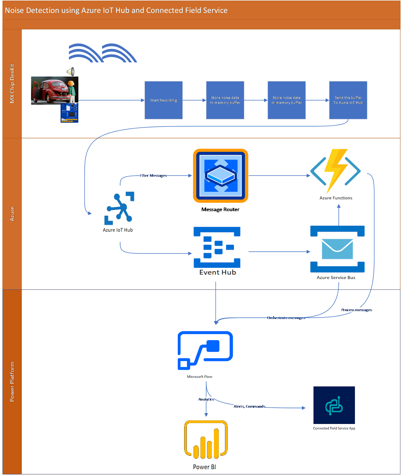

Architecture
The architecture of this sample is very simple. I am using an IoT Hub and Azure function to calculate and propagate the IoT events to the #PowerPlatform. On the device side, there is an Arduino application running which listens to noises and sends the noise to the Azure function.

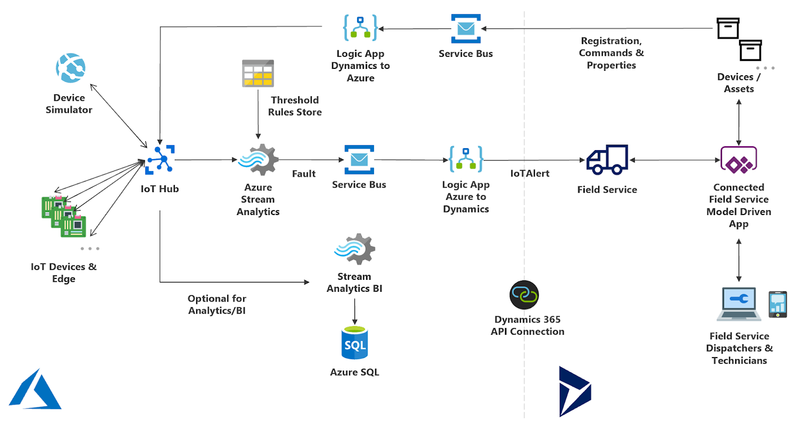

A very comprehensive architecture of a connected field service is created in the below diagram which can simply be implemented using the #ConnectedFieldService application. However, I just wanted to implement it in a simpler way. Full details of the #ConnectedFieldService architecture can be seen in this documentation.
Components
The logical diagram of components is demonstrated below:

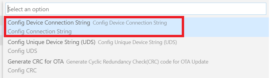

Handshaking
In order the device to send messages to the Azure function, the device must know the endpoint in which it should send the data. You can take steps in the this link to register your device with Azure function. It is all about using Azure IoT Workbench.
