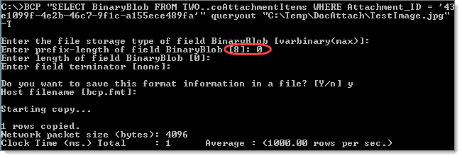

When I ran the BCP command, it asked me four questions, and then prompted me to save those settings to a format file.  I accepted all of the default options except for the header length—that needs to be set to 0, and then saved the file as the default bcp.fmt.
BCP "SELECT BinaryBlob FROM TWO..coAttachmentItems WHERE Attachment_ID = '88d9e324-4d52-41fe-a3ff-6b3753aee6b4'" queryout "C:\Temp\DocAttach\TestAttach.txt" -T -f bcp.fmt
BCP "SELECT BinaryBlob FROM TWO..coAttachmentItems WHERE Attachment_ID = '43e1099f-4e2b-46c7-9f1c-a155ece489fa'" queryout "C:\Temp\DocAttach\TestImage.jpg" -T -f bcp.fmt
I found that BCP was able to extract the files from the Document Attach table and save them, and I was able to then immediately open and view the files.  Dynamics GP does not appear to be compressing or otherwise modifying the files before saving them to the varbinary field, so no additional decoding is required.
