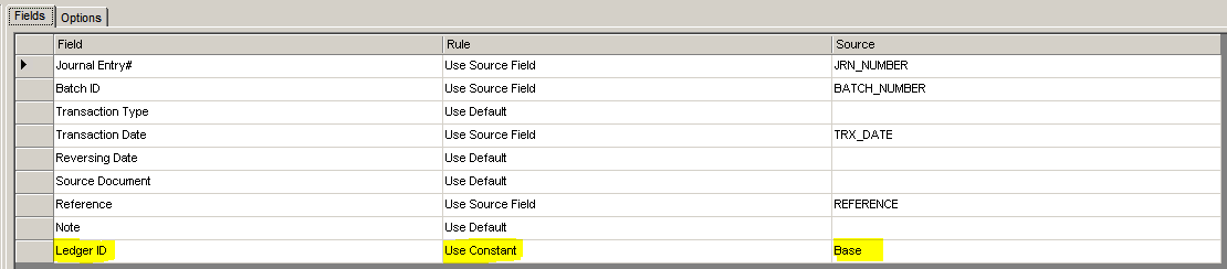

This issue is quite frustrating. The issue happens with Integration Manager v2010 for GL Transaction With Analytical Accounting adapter.
I had to integrate a GL Entry with AA Apportionment information. I configured everything as it's required. When I ran the integration, it thrown the below error message:
I had faced this error while doing my first such integration and to solve this error I used to setup the Destination Mapping for GL Transaction as follows:
Highlighted above are the settings that we require to do.
There was a Community Post which reported the same error. You can read that post from here: IM11 hit aagCreateGLWorkDist error.
Before I did this integration, I read the post and even replied saying the Destination Setup "Ledger ID" assignment would solve this issue. BUT, on a contrary, it does not solve this error at all.
I even went to the extent of modifying this Stored Procedure aaCreateGLWorkDist (AA Developers must spare me on this, as it was just to understand the root cause of this issue). I made sure that a NULL value was passed on to @LedgerID parameter. Even if you change the code inside this procedure to use ISNULL() and replace it with relevant integer value (for a trial), it still do not work that way.
So that means, either I am still missing something on IM Destination Mapping OR this is a bug in that Stored Procedure or whichever is calling this SP.
