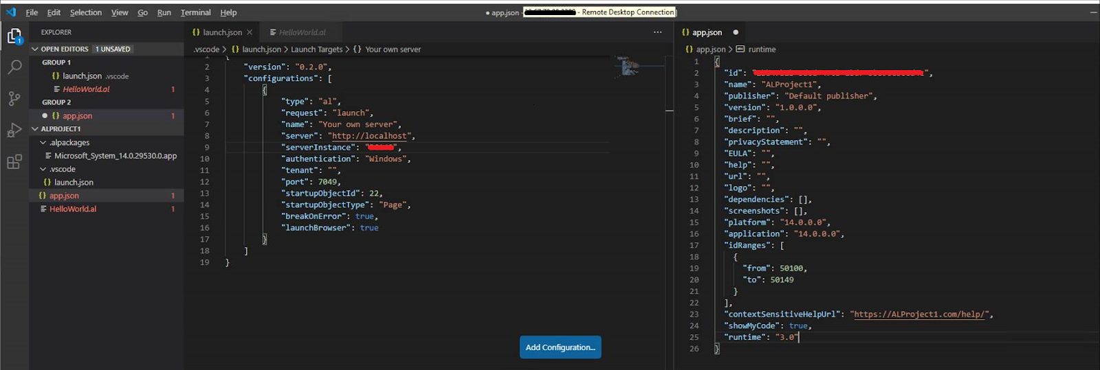

App.json and Launch.json

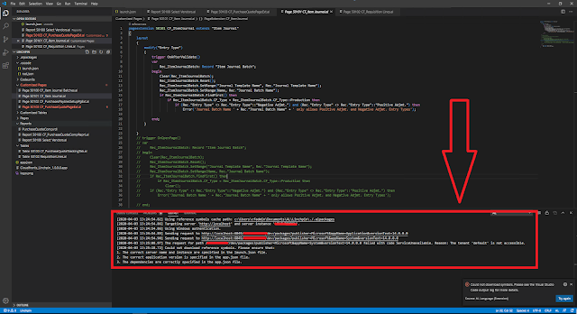

This is where I noticed that, even after reverting back to the standard Demo BC(14-0) Database no longer helped. The only error I got was "The tenant 'default' is not accessible error".
I tried changing the AL Language Extension for VS Code guessing this could be a potential issue that BC v16 AL Language might not be able connect to BC v14.
Also, to ensure I created a new Server Instance and Web Server Instance, and tried connecting the same error "The tenant 'default' is not accessible error"
Despite all the configurations being correct in project's app.json and launch.json, I could no longer connect to Business Central, I couldn't download any Symbols and I couldn't publish any Extension to Business Central.
| App.json and Launch.json |

| AL Project : The tenant 'default' is not accessible |

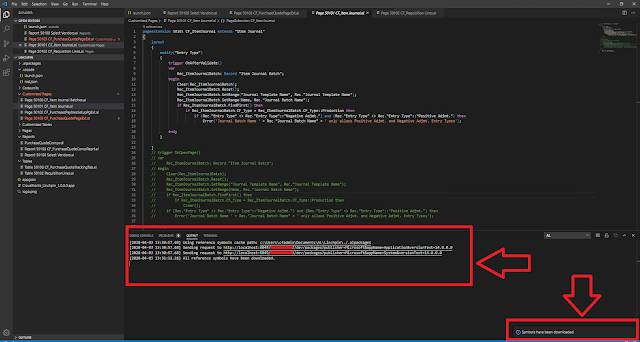

5. Check if AL Extension in VS Code can connect to Business Central:
After Restarting the Business Central Instance, I tried to connect to AL Project with Business Central Server.
| AL Project: Symbols have been downloaded |
Finally, I got it running and now I can deploy the Extension App to Business Central.
