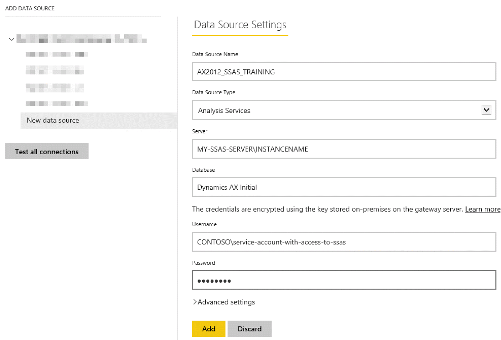

Head over to the Manage gateways and click "Add Data Source".
Fill in the form. Notice I am using the name of the server where SSAS is running and the name of the SSAS instance. I also use the domain user who has access to the SSAS Server itself. I also put in the name of the OLAP, Dynamics AX Initial.
The data source should connect and confirm everything looks good for you to connect the data source and whatever it contains. Great!

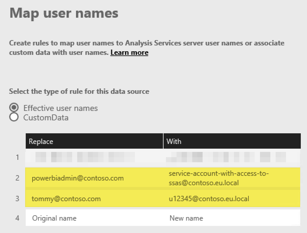

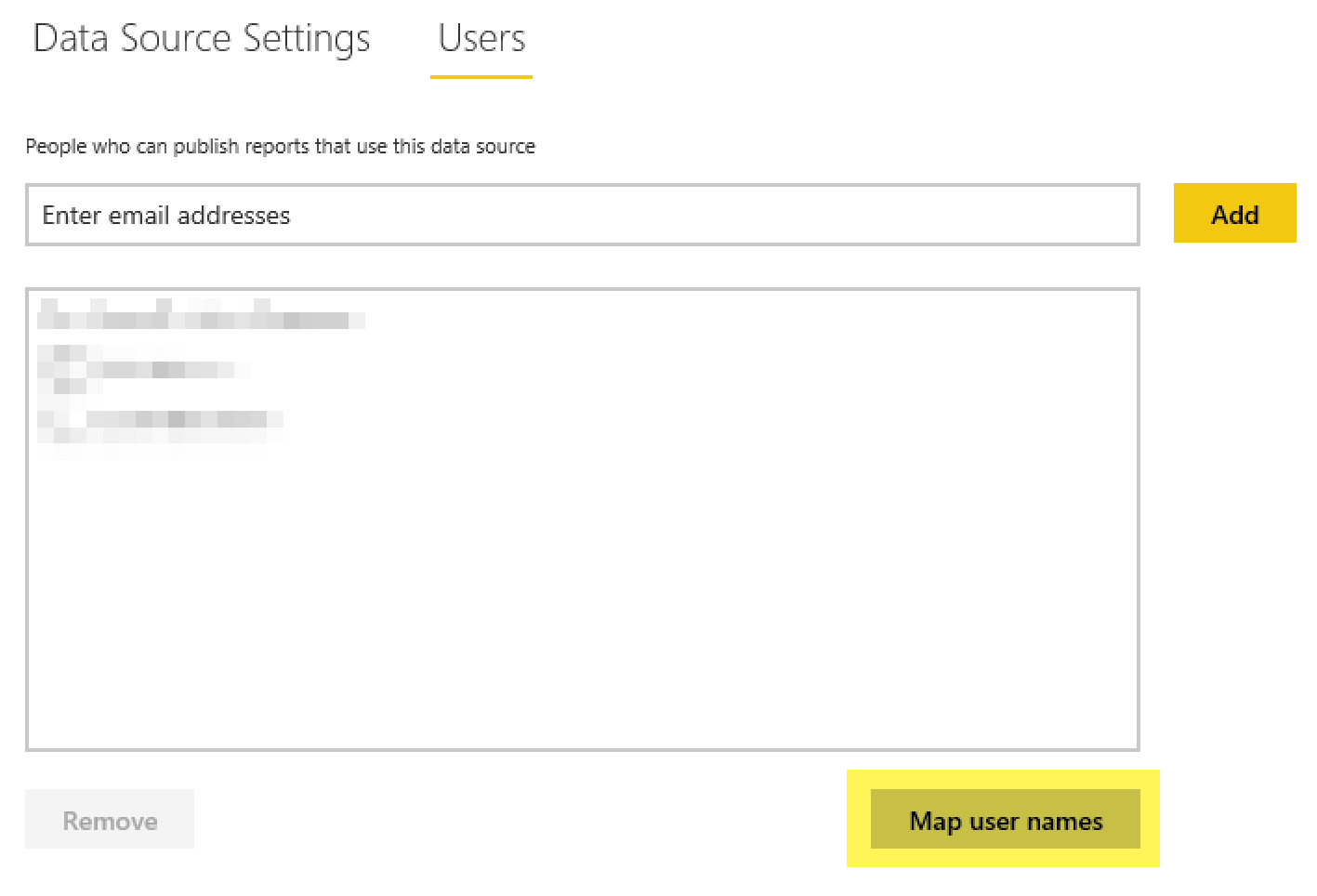

Click the Data Source you need to be mapped. Right now, these settings are not shared across data sources, but hopefully they will add further administrative improvements to this.
Open the list of Users and look at the bottom for the Map User Names button.
This will slide in the setup for mapping of user names.
Notice in my example I am replacing the long username for the powerbiadmin@contoso.com with service-account-with-access-to-ssas@contoso.eu.local. So anytime I am logged in at the PowerBI portal with this powerbiadmin-user, and I try to access the data sources through the gateway, the user principal names will be "washed" through the mapping, and "magically" the credentials for that user will work On-Premise because the local domain sees a user it recognizes. Furthermore, I added another example of a user who locally is represented by u12345@contoso.eu.local, while in Azure AD is actually tommy@contoso.com. So if this user also tries to update or refresh data sources, the credentials will work locally.

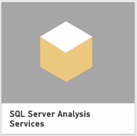

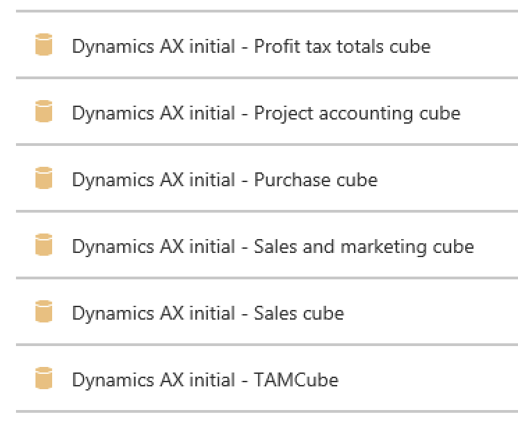

Well, you can click "Get Data", select "Database" and choose "SQL Server Analysis Services" and simply pick your preferred cube from one of your datasources and click "Connect". With the new dataset in place, you can schedule a refresh outside regular business hours. Like this:

Q) What happens if I map two completely different users, who actually both exists both in Azure and On-Premise?
A) You're the admin and while there are no features to prevent potential illogical mappings, you can map yourself into complete chaos - at your own or someone else despair.
Q) Do I need to map all users like this?
A) Since the mapping is a simple string replace, you can replace similar parts of the username. Like replacing "@contoso.com" with "@contoso.eu.local". If you're lucky enough, this will be enough to fix most usernames. Also consider there may be a number of users who only will load the Reports, but who do not need access to actually reload the datasets with fresh data from the data sources. Surely, those users do not need to be mapped.

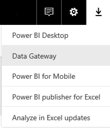

Given all of the above, you'll simply start by logging on the PowerBI portal using the Office 365 Global Admin user, and download what's called the "Data Gateway". The download link is in the top and takes you to the download page. Press Download and get the latest and finest version.
When you run this installer, it will ask you to login using the Office 365 Global Admin user (which will have access to register the gateway). Also, I am using the "Enterprise Gateway" option when installing. This allows me to schedule refresh from data sources based on SSAS.
