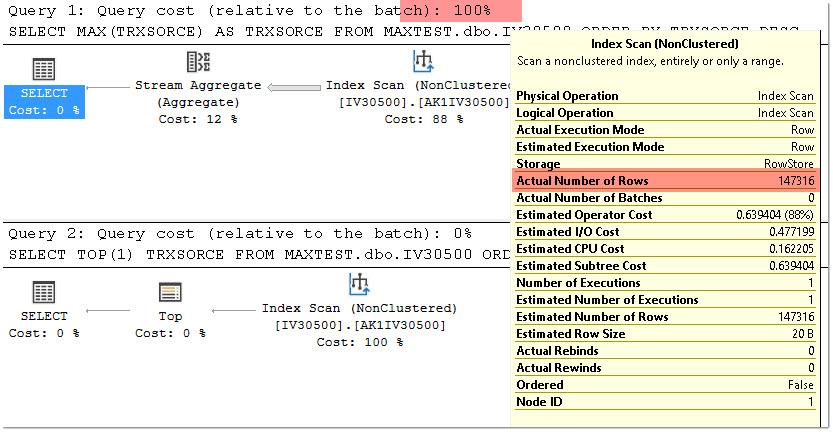

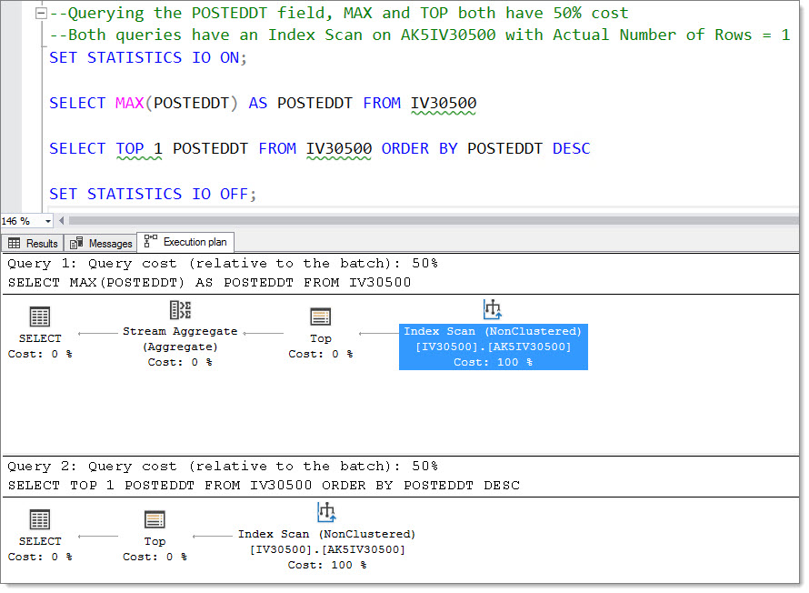

When querying some fields, such as the IV30500 POSTEDDT, with no WHERE clause, both MAX and TOP 1 perform virtually the same, with both using a very efficient Index Scan. 50% vs 50% relative costs.
But when I query the TRXSOURCE field, with no WHERE clause, MAX shows 100% relative cost, whereas TOP 1 shows 0% relative cost.
What???
The POSTEDDT query uses an Index Scan. The TRXSOURCE query uses an Index Scan. But for some reason with the TRXSOURCE query, MAX is much more costly.
I stared at this result for a few hours trying to figure out why. I eventually found this tiny little detail.
Notice that the Actual Number of Rows for the MAX Index Scan is 147,316. That's every row in the table.
By contrast, the TOP 1 Index Scan has Actual Number of Rows = 1.
What is going on?
For some reason, the MAX is having to scan the ENTIRE AK1IV30500 index. It isn't getting much benefit from the index.
What???
What is going on?
