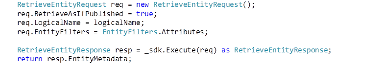

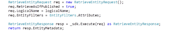

The procedure for retrieving entity metadata is relatively straightforward. Let’s first take a look at the general structure of the request, with the required fields used.
clip_image002
In order to retrieve the entity metadata, you first need to perform a RetrieveEntityRequest, for which the response is basically just a container for the Entity Metadata.
The required parameters for the request are:
  • EntityFilters
    • A filter to control how much data about the entity is returned.
  • RetrieveAsIfPublished
    • Set true to include unpublished changes to Entity, as it would look if you called publish.
    • Setting to false includes only published changes to the Entity.
Either LogicalName or MetadataId is required to inform the request which Entity it is you wish to be returned.
From the response, the EntityMetadata can be accessed. What information is contained here is determined by the EntityFilters defined in the request. In our case, this is the Entity’s attributes.
