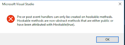

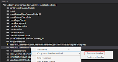

During my development I have to run a block of code before calling of method in a class. So when I tried to create a Pre-Event handler of the method it throws an error because of Protected access modifier of the method.
So what I have done to achieve this is that I have created an extension of a class and copied the protected method and defined my code block after that, then I have simply called the base method by using next keyword. By doing this I have given my own Pre-Event handler implementation without using any event handler as shown in below images.
